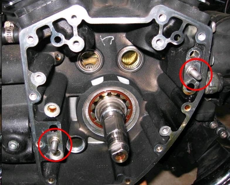

I switch my bike's to ARP 12pt stainless fasteners too. I do it for the looks, and because I find the 12 pt fasteners easier to remove on the derby cover and other engine covers than the hex head fasteners.
As far as on the cam plate, I have always used the OEM fasteners, with the exception of changing the two dowel position fasteners to studs with 12pt nuts. It was pointed out on a tech site I read, that due to the dowels, those bolts don't engage as many threads as the non-dowel bolts do. Changing to studs removes the possibility of stripping out those bolts. While it's not a common occurrence, it does happen from time to time.
To answer your specific question, since the cam plate fasteners are not visible once the engine is reassembled, they are constantly bathed in oil, and not exposed to the weather, I wouldn't hesitate using the ARP black anodized bolts supplied by Fueling with their cam plate.
FWIW...here's the doweling bolt conversion to studs w/12 pt nuts:
