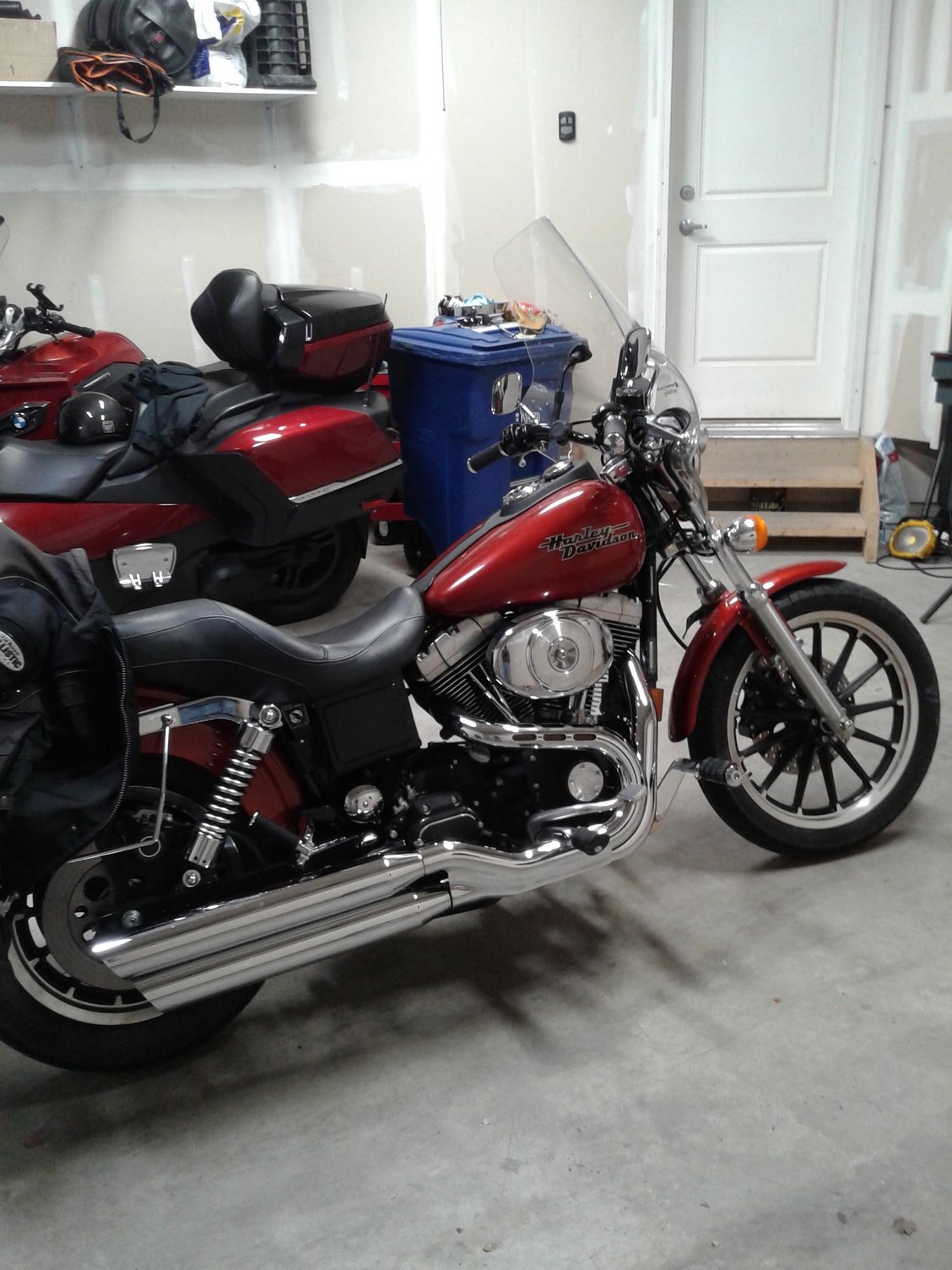

I really do like the looks of that exhaust a lot. Do you mind if I ask what you paid for it...?
Also are they 1 3/4 ID pipe ?

The exhaust is stock take off's from a 2008 Fat Bob.
Spent some time checking with the local shops I normally deal with and one of them had a set in the back.
Out of respect for the shop I won't say what I paid.
Head pipes are 1 9/16 ID. Same as the Pro Pipe.

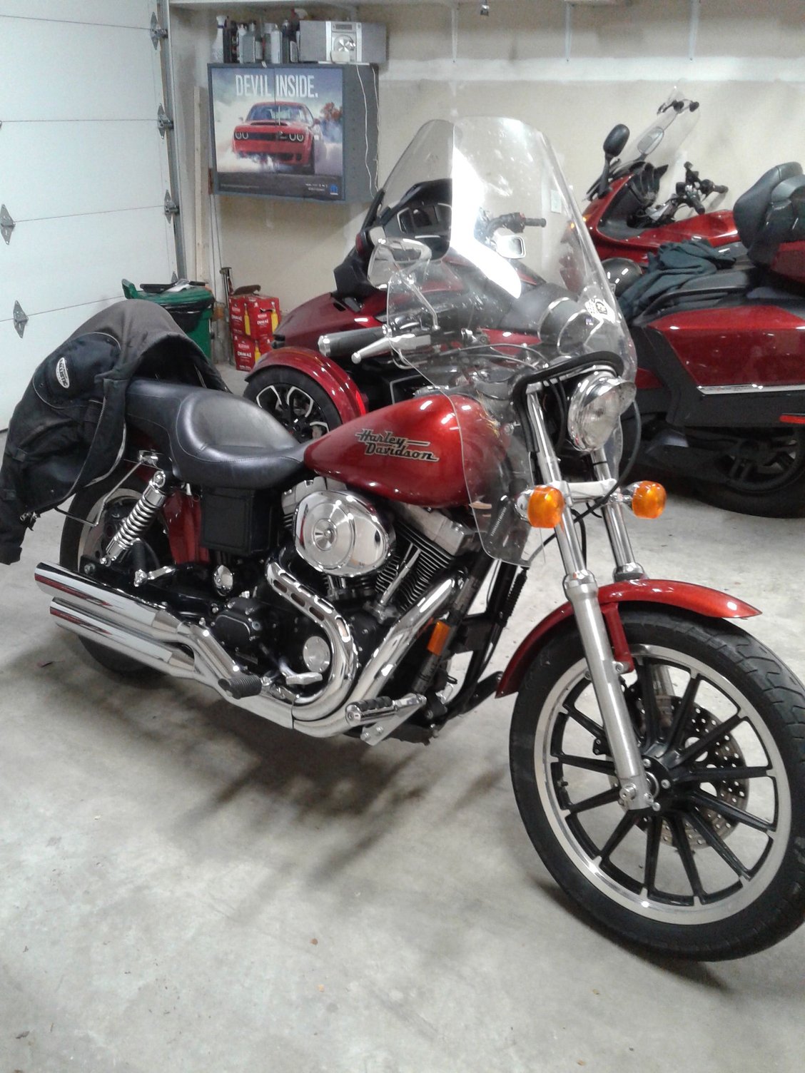

Finished installing the Fat Bob exhaust. I also decided to remove the Super E and install the CV40.
only have a base tune for now but got a bit of a ride in and like the way it runs. May have lost a bit of power above 5k
but runs well below that. Still going to swap the 34 tooth pulley for the stock 32.

I am using the factory mufflers that came on the head pipes.
For the mount I just modified the stock 2008 mount to fit on the 5 speed trans case.
I can get a pic later, however I think it should fit on your 6 speed trans better.
