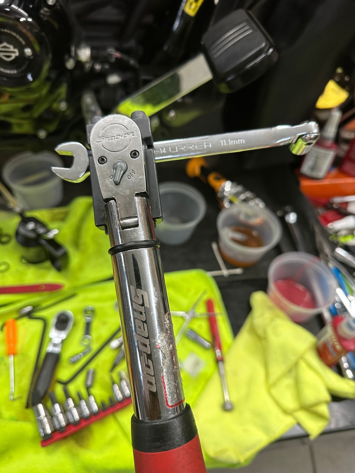

Any of you guys ever use one of these?
TITE-REACH 1/4" Professional Extension Wrench - Torque Wrenches - Amazon.com TITE-REACH 1/4" Professional Extension Wrench - Torque Wrenches - Amazon.com
I was thinking of picking one up to assist with the lower rocker box bolts.

You’re talking about the cover bolts, right?

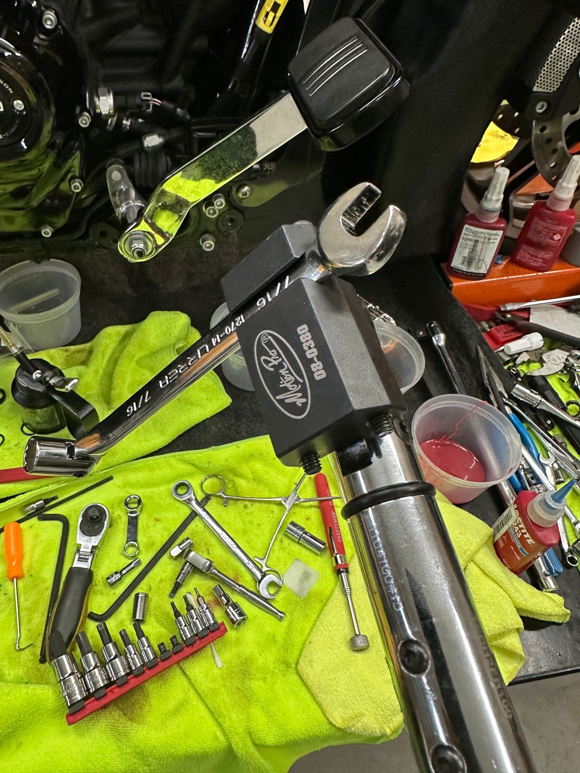

Either way, I used a motion pro torque wrench adapter and some bucket wrenches. The advantage is both the adapter and the wrenches came in handy in so many more instances than (I think) the thing you showed probably would.
I’d recommend these - a little more $ but more flexibility IMO.
Amazon Amazon
Amazon Amazon
https://www.amazon.com/gp/product/B0...?ie=UTF8&psc=1
I only have photos from my M8 RK build, but same applies to a Dyna
Yes, the lower cover bolts and that would get me there, thanks for that!

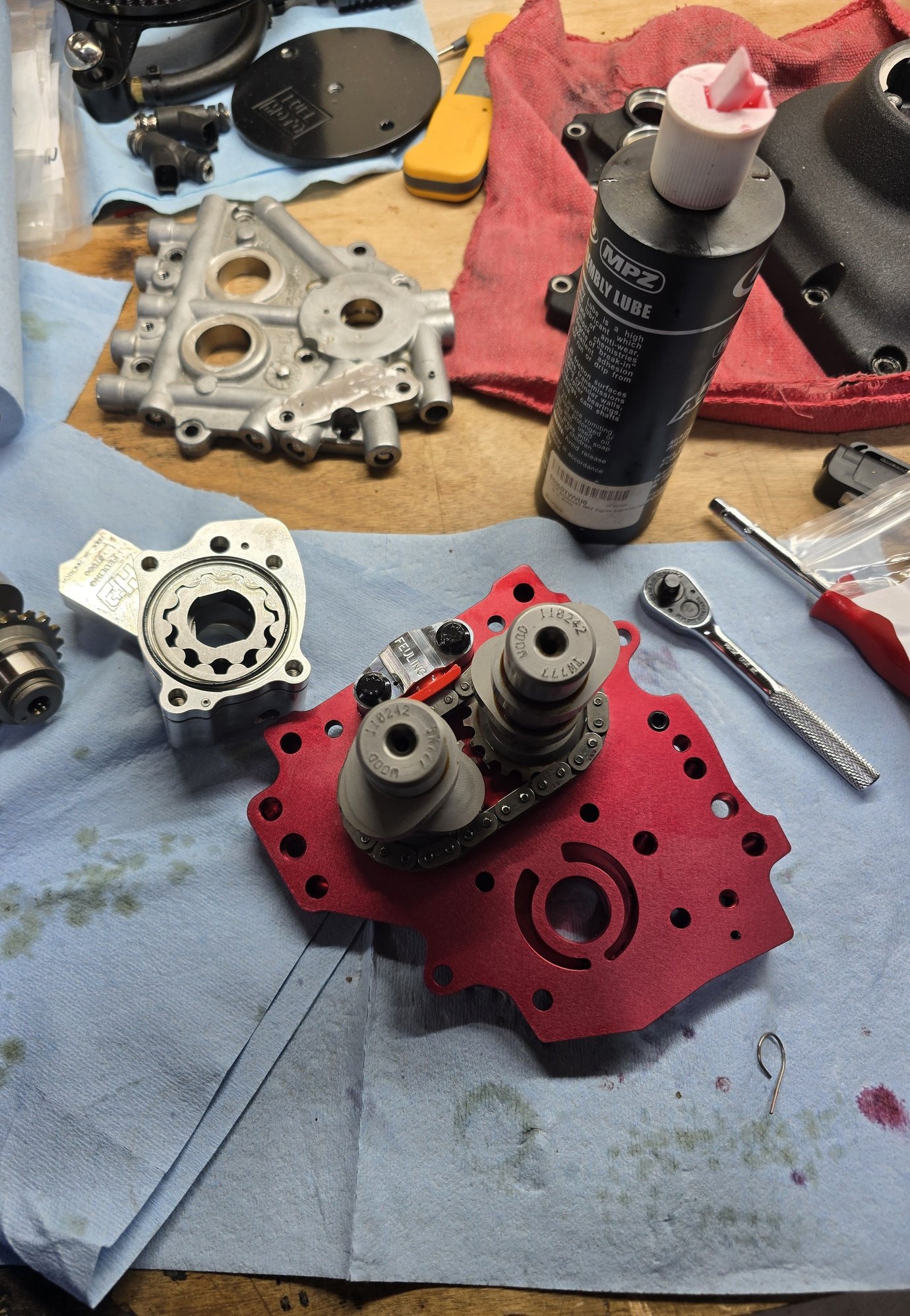

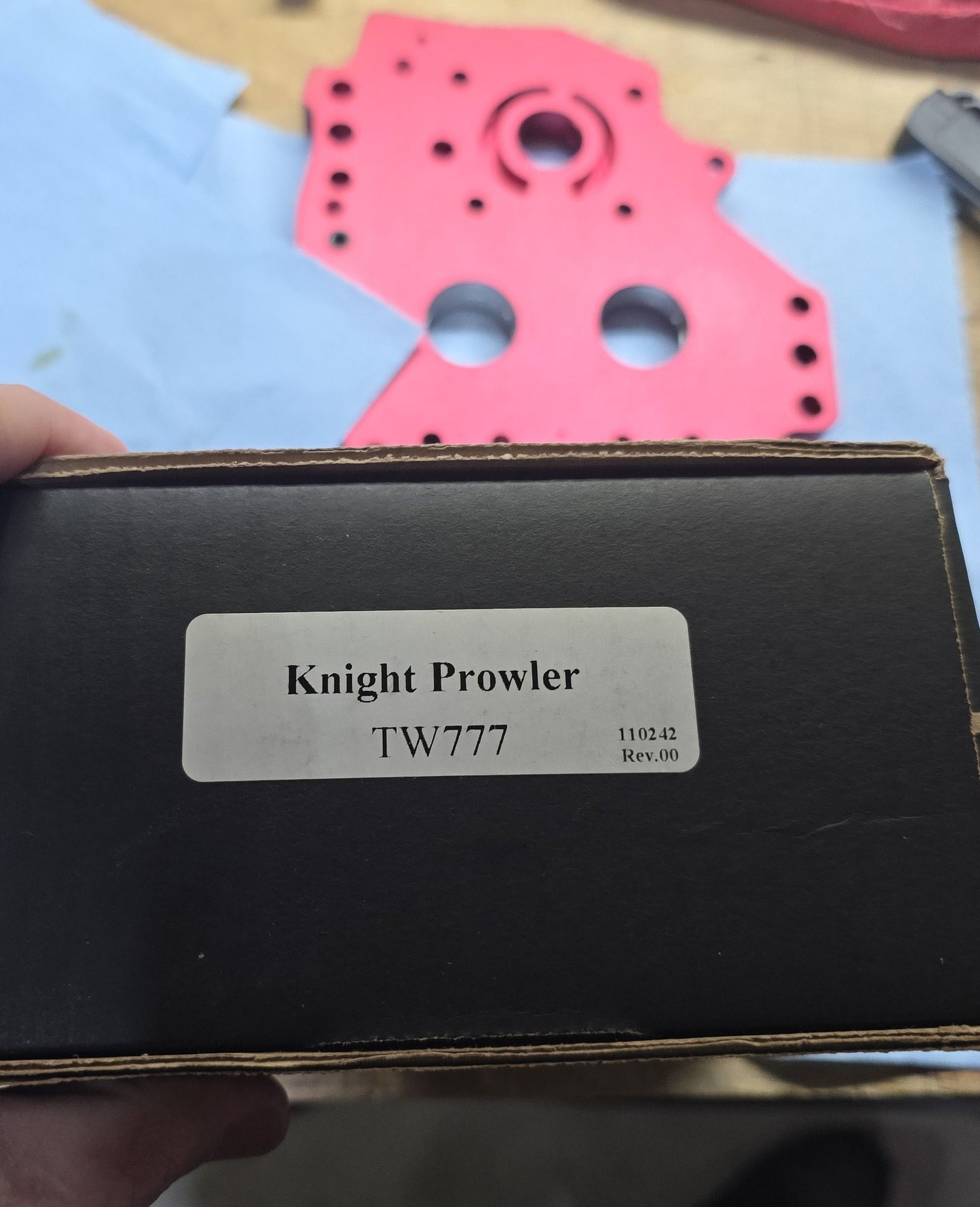

Got a little bit more done today but I've got a cold that's kicking my *** and realized I didn't order ARP's for the oil pump so I'm stopped again for the day,
Woods 777's
New Feuling High-Flow Camplate and tensioner with ARP's
Feuling HP+ Oil pump that was already in the bike.

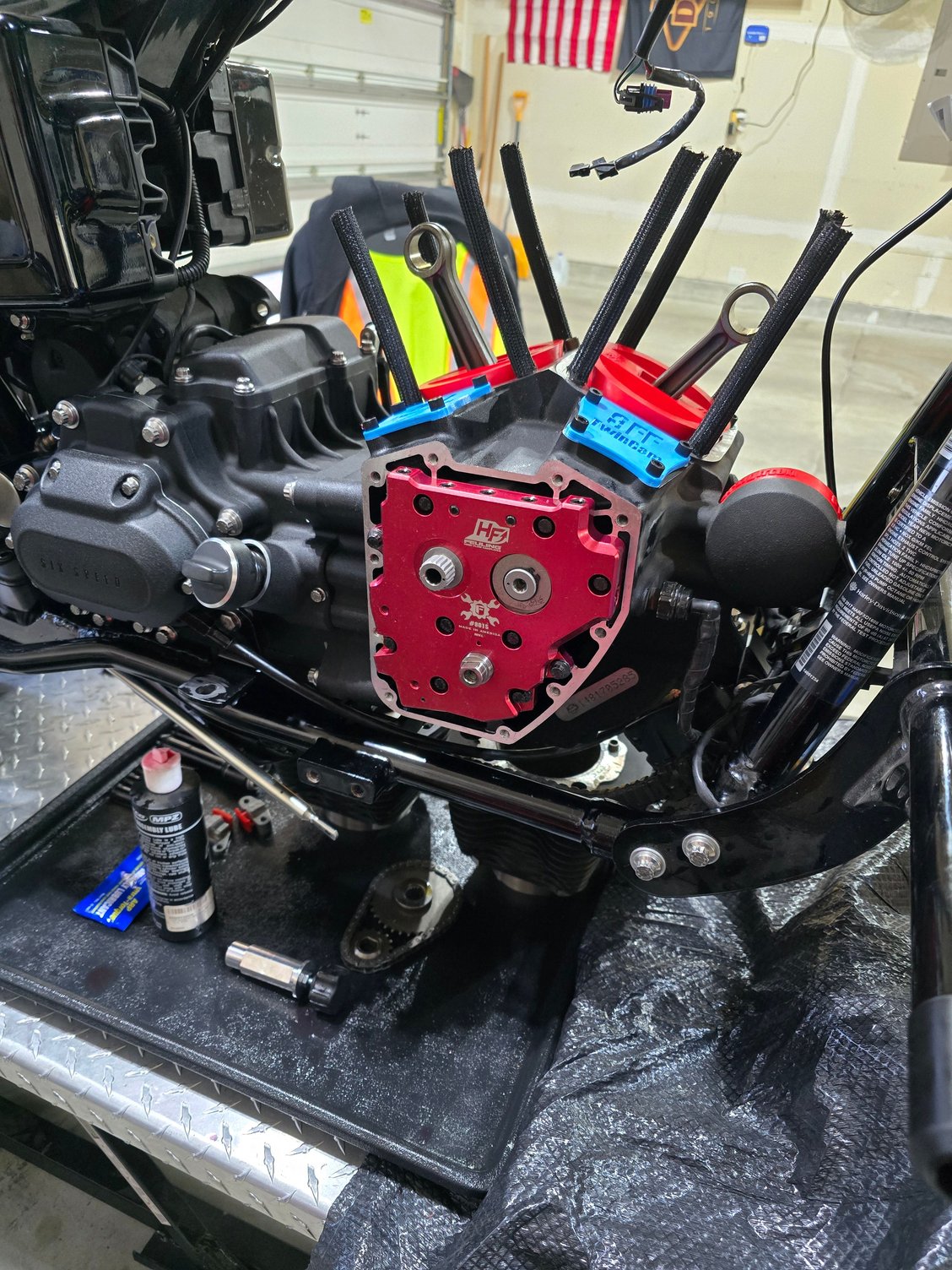

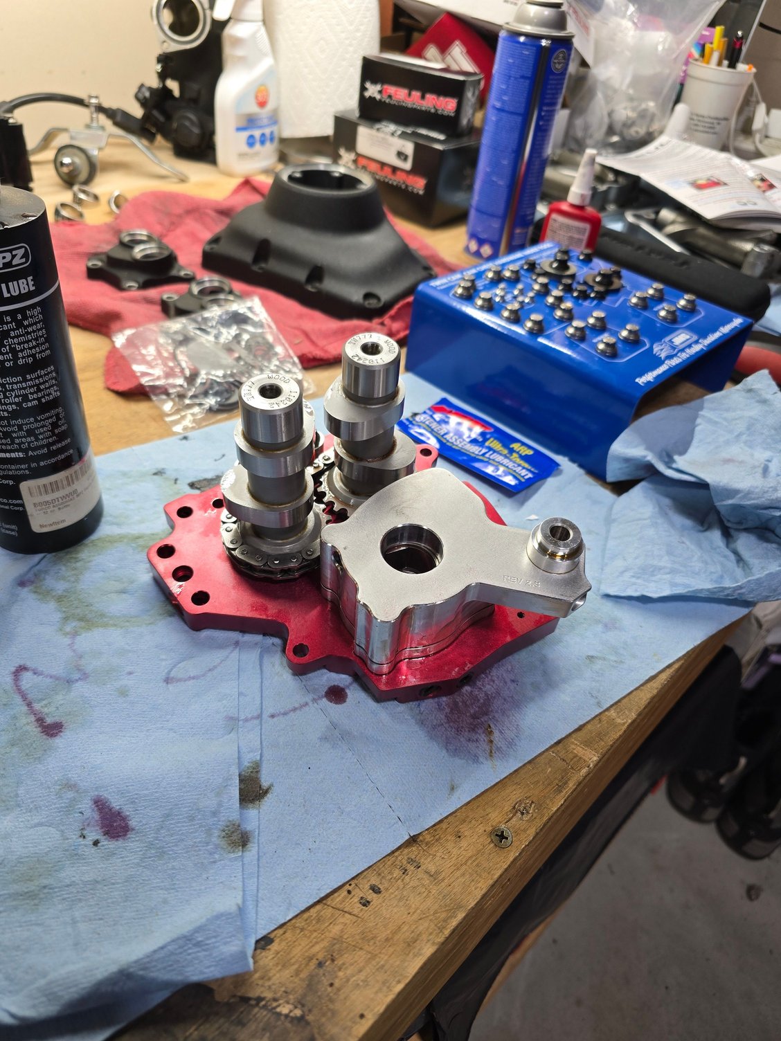

A little more progress over the weekend. Got the Feuling pump installed to the cam plate and the cam plate in the bike. I gotta tell you, the tolerances on that oil plate are tight AF, it took a lot of patients and gentle finagling to get it in place. Also installed the HD proximity fob system that my wife got me for Christmas, I'm really looking forward to having that.
