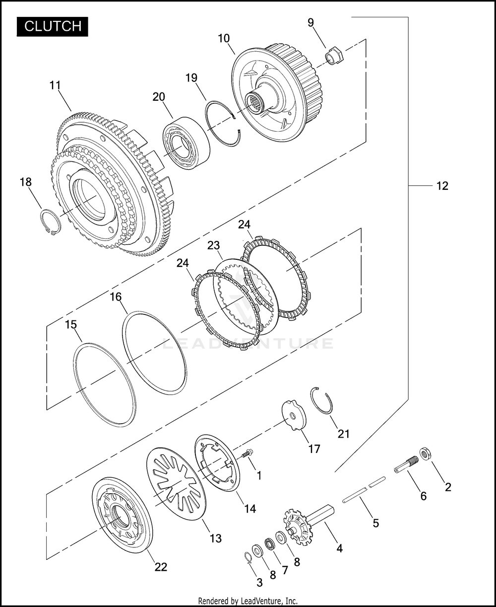

That year uses a judder spring to prevent clutch squeal so maybe it has failed...parts 15 (seat), 16(spring), and 24 (special narrow clutch plate) below.
