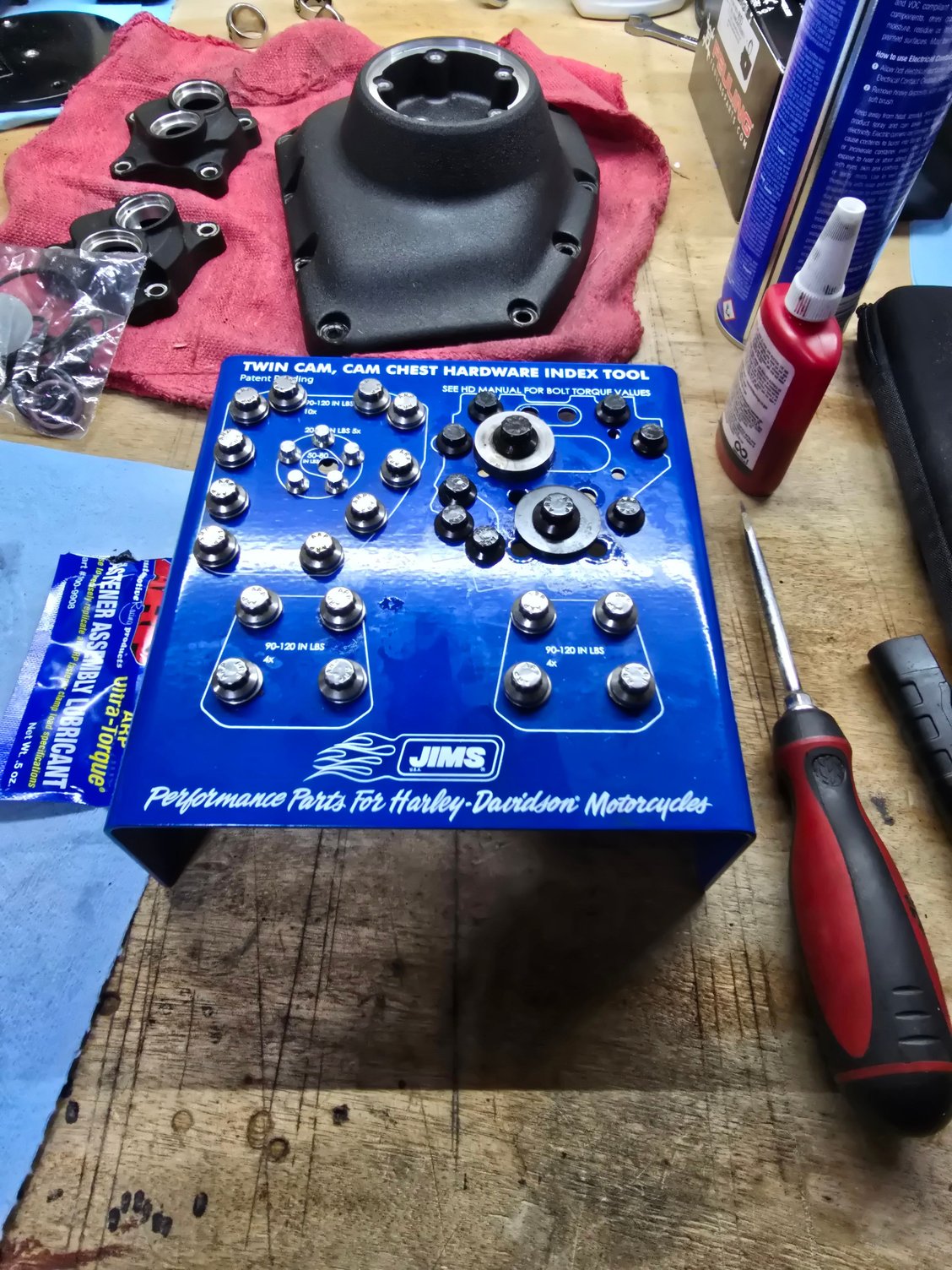

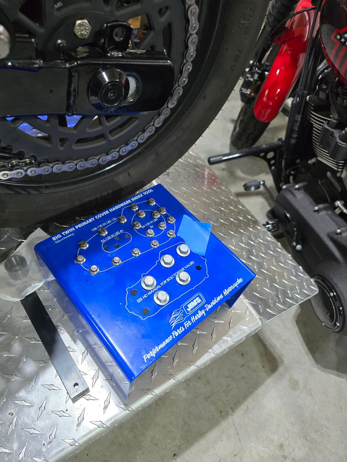

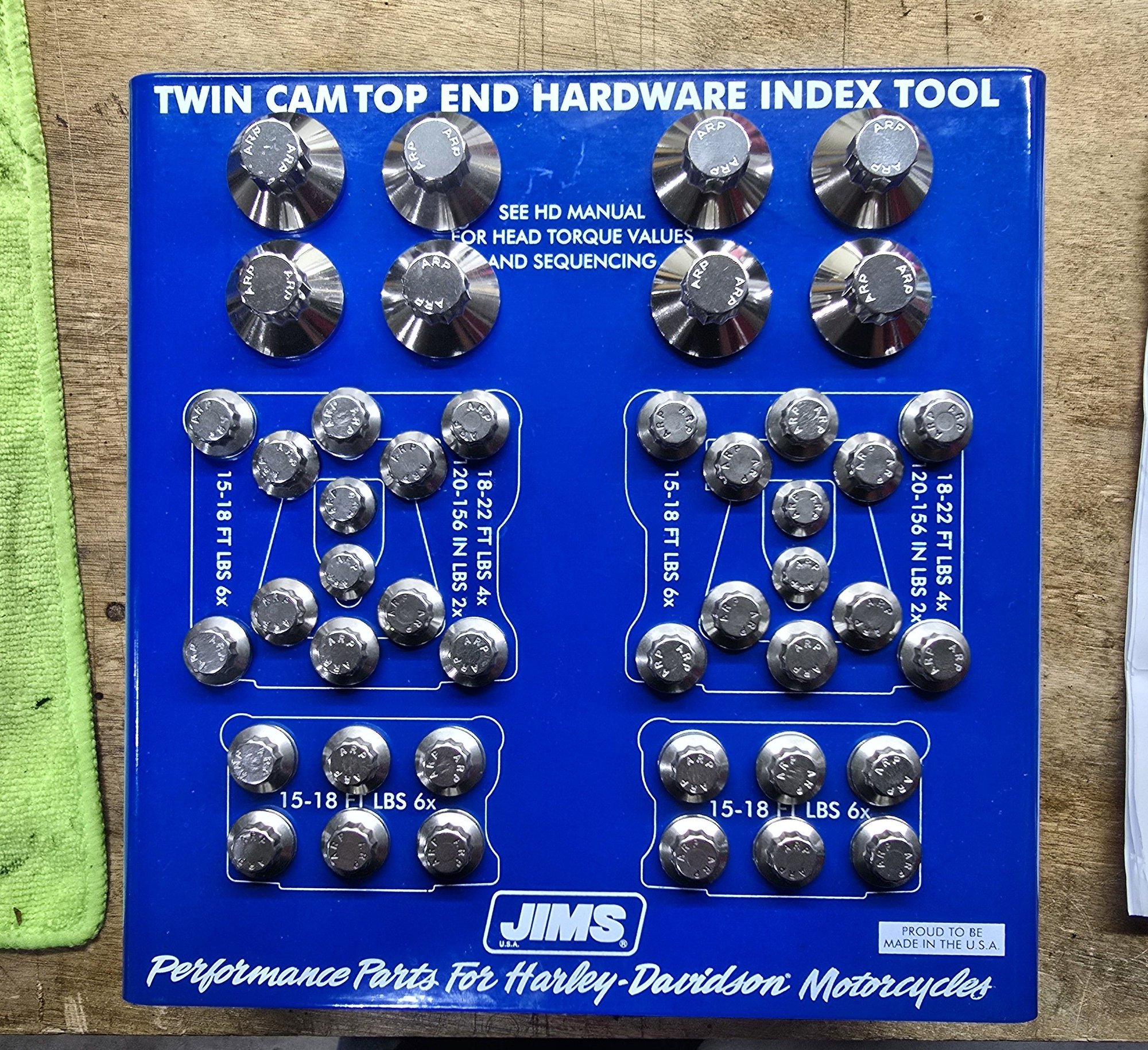

indeed.. I have baggies going on. I’m also replacing the engine bolts with new ARP bolts. So I have labeled bags for bolts. And I’m just swapping them out.

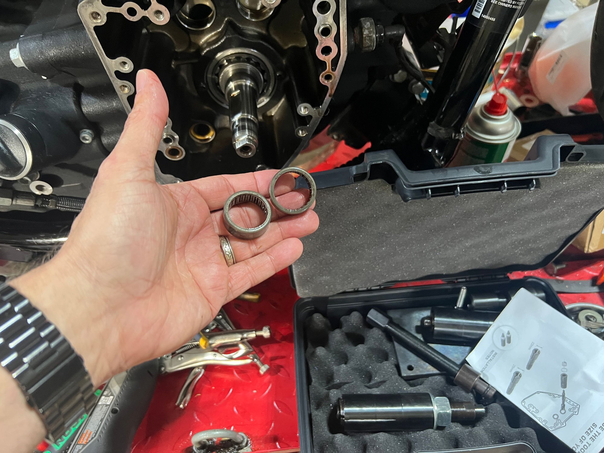

I did slip out in the garage and pulled the cam bearings while a buddy was over to press out some Triumph bushings.

Ooooh I like that, I usually take a box and punch bolts into it to make a poor man's version. If I did builds regularly I'd have one or make a 3D printed version.
