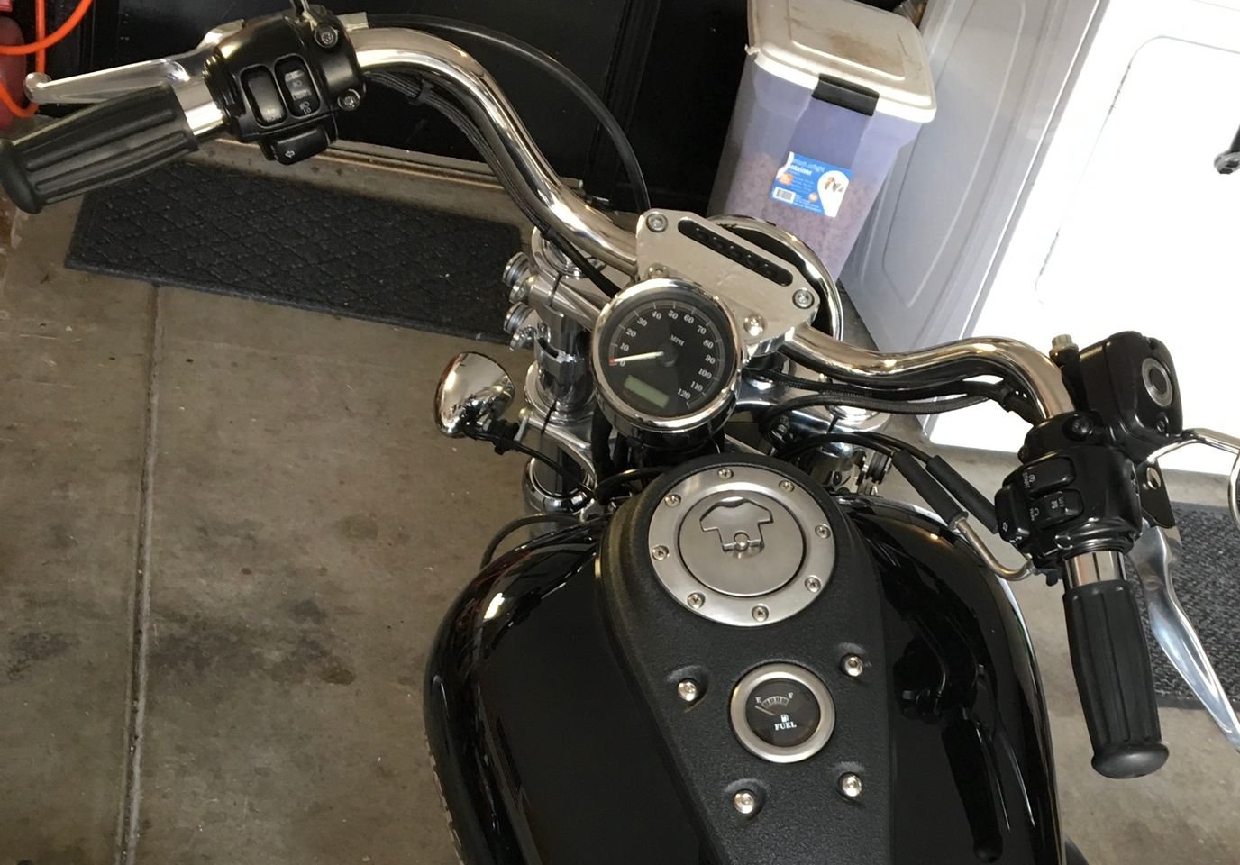

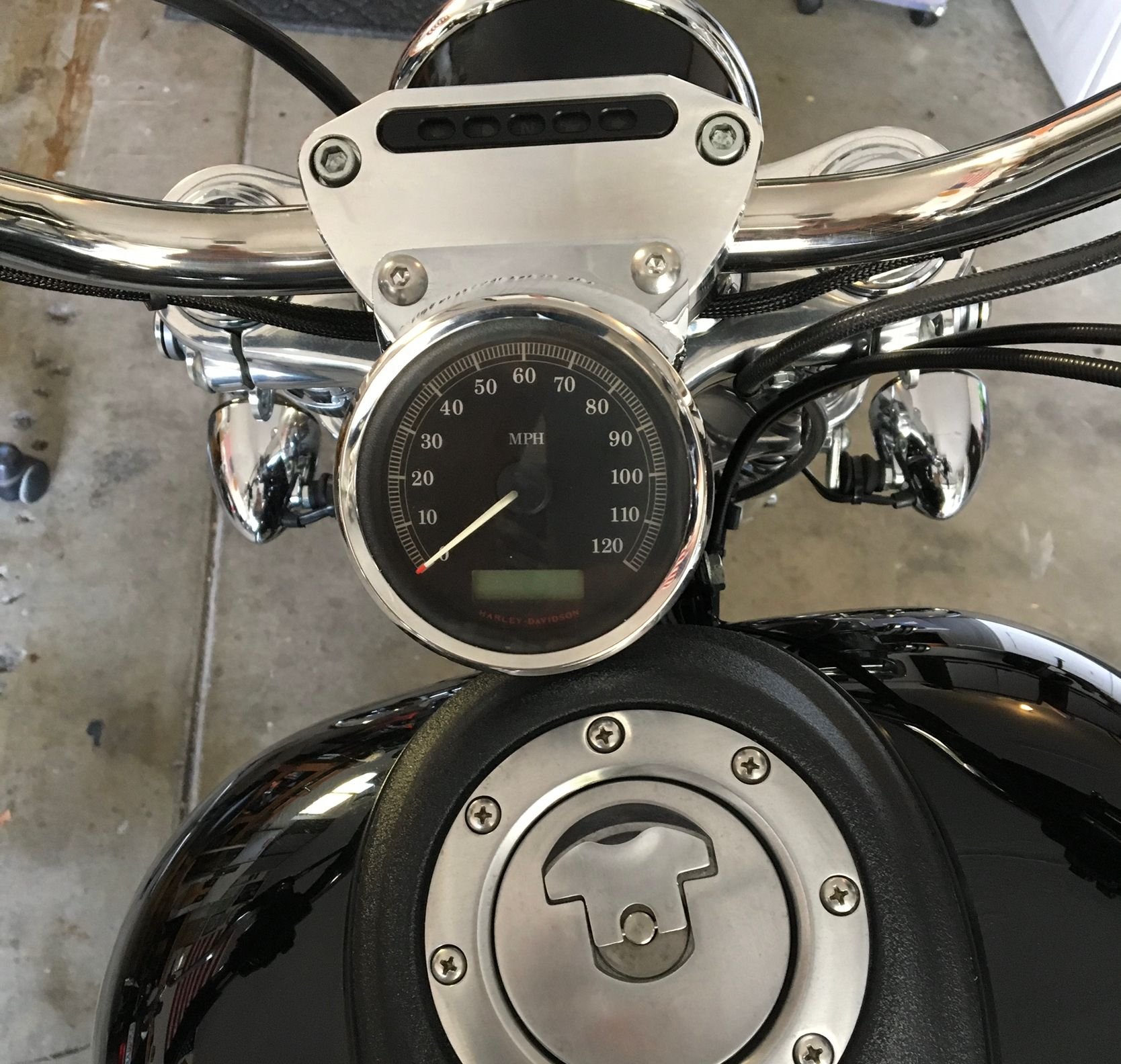

Originally Posted by Callandenis
I want to put it on my super glide so that I can take the speedo off my bars. But I’m trying to find the speedo for this tank.
There is a cheaper mod you can do that lets you keep your current tank and console. The fxd in my opinion has one of the coolest consoles of all time.
I didn’t like my speedo sticking up in no man’s land either. I got a bracket from an 08 XLC and put it on my 07 fxd. Still bar mounted but brings it down nice and tight.
here’s an 08 xlc for reference. And a couple pics of it mounted on the fxd.

One more point— if you do change tanks you reuse your current speedo and indicator lights. Will mount right in the street Bob console.
