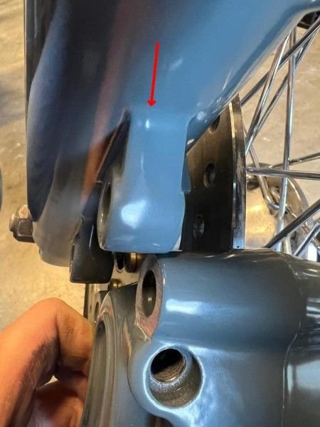

You're in to it this far; I'd look into the practicality of milling down the lugs on the caliper.

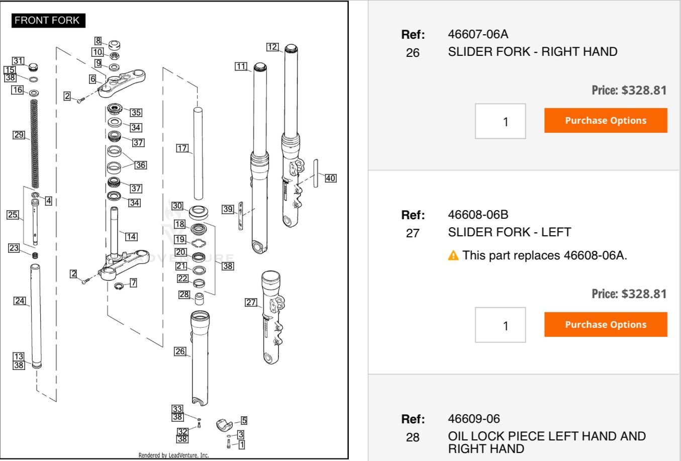

Ah, that makes sense, I asume 'slider' is the spacer, that needs to be 30mm instead of 25mm, i'll have a look at the parts fishes, I'll post the result here. Thnx!
He means the actual fork lower, the piece that the fork tube slides in and out of going down the road. I'm guessing the casting pushes the caliper mounting point closer to the wheel because of the width of the Wide Glide fork. Did you say that the caliper was never mounted when you got the bike? I don't know why the original owner would have changed a left side slider/lower unless it was damaged somehow.
no #27 is the slider

Before you do anything else, confirm that the forks are parallel to each other. It's probably an illusion, but the last picture in post #5 makes them look like they're pulled together at the axle.

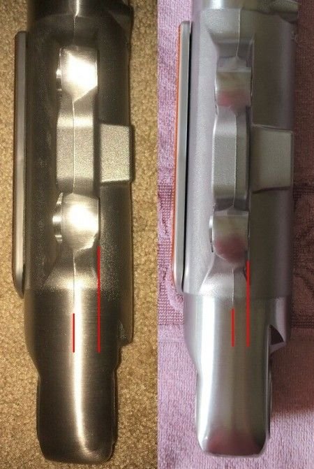

Unfortunately, you have the wrong Left Silder installed.
The one installed is for a "Wide Glide" or Fat Bob. Which one could be determined by seeing the fender mounts, but I'm guessing WG unless you see modfications to the fender to make it fit.
Regardless, you need a different slider
Just to elaborate on identification ... first you need to know there is such a thing and then how to visually identify. The identifier is the location of the caliper mounts in relation to the slider casting line.
See the casting line below
Another 49mm reference with WG slider (like yours) to the Left ... Std FXD to the Right
You're the man!
