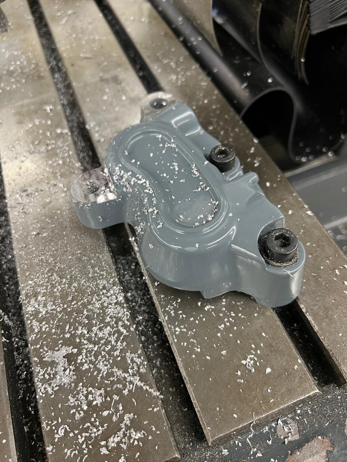

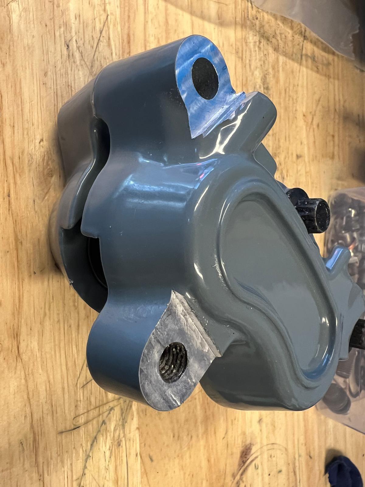

Originally Posted by John CC
You're in to it this far; I'd look into the practicality of milling down the lugs on the caliper.
Something like this might work in my drillpress...
Old Apr 1, 2025 | 08:59 AM
Max Headflow's Avatar
Max Headflow
Joined: Dec 2005
Posts: 20,021
Likes: 8,076
From: poway
Like this. I did both sides in this case just to clean off the powder coat.
Old Apr 3, 2025 | 09:56 AM
dutchmike's Avatar
dutchmike
Joined: Jun 2019
Posts: 27
Likes: 9
From: Landgraaf
done som milling, now it fits perfectly. Don't know why parts were swapped,
