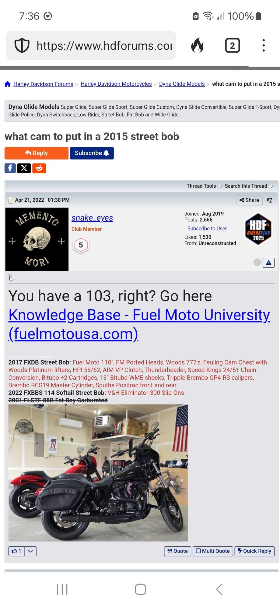

Originally Posted by benscratchin
Didn't you ask about this before, back in 2022?
You received some good replies back then. Here is Snake Eyes reply >
yes and I just finally got around to getting cams in. That portion is all done with, now I've just been trying to figure out the whole tuner, dyno portion. Seen many say just a tuner, others say, tuner and dyno. I lack knowledge in that area of what's best
