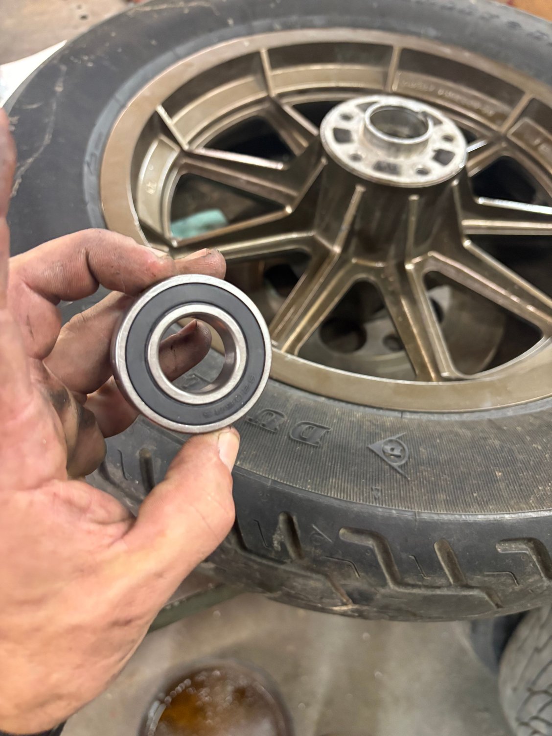

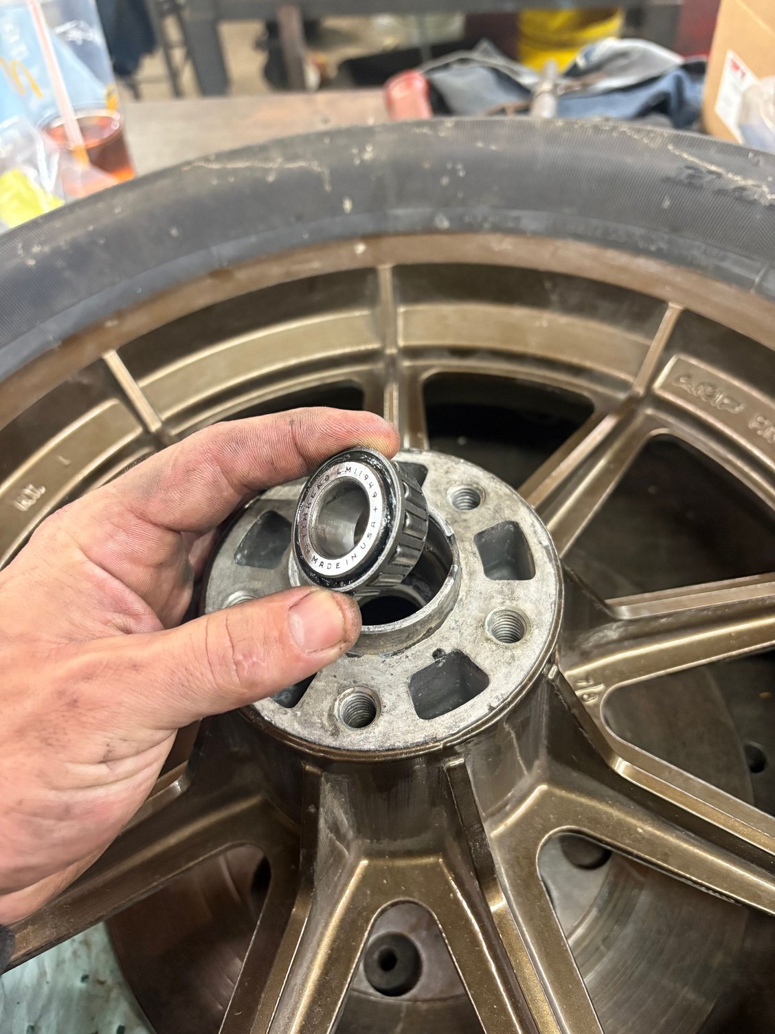

i bought a set of 9 spoke mag wheels over the weekend, guy told me they were one inch bearings, my fault for thinking someone knows how to measure and not double checking
anyway, i have a 2012 dyna superglide with stock spoke wheels, the bearings in the wheels on the bike now are 25mm, they are also the normal sealed bearings that you just press in, the wheels that i picked up have 3/4 tapered bearings in them and theres not enough material to bore the wheel to get a 1 inch bearing in there, so, im on here seeing if anyone else has had this issue and if you did were you able to figure something out? is there a chance of ordering tapered bearings like the 3/4 but with a 1 inch id and the same race OD, i attached some pics to show what im talking about

Only solution I know of are the Vulcan engineering conversion axles. Used them to swap early wheels to my ‘08. Excellent quality.
Old May 28, 2025 | 06:46 AM
Bubba Zanetti's Avatar
Bubba Zanetti
Posts: 21,084
Likes: 19,246
From: The Wasteland
This is probably the right answer.^^^
