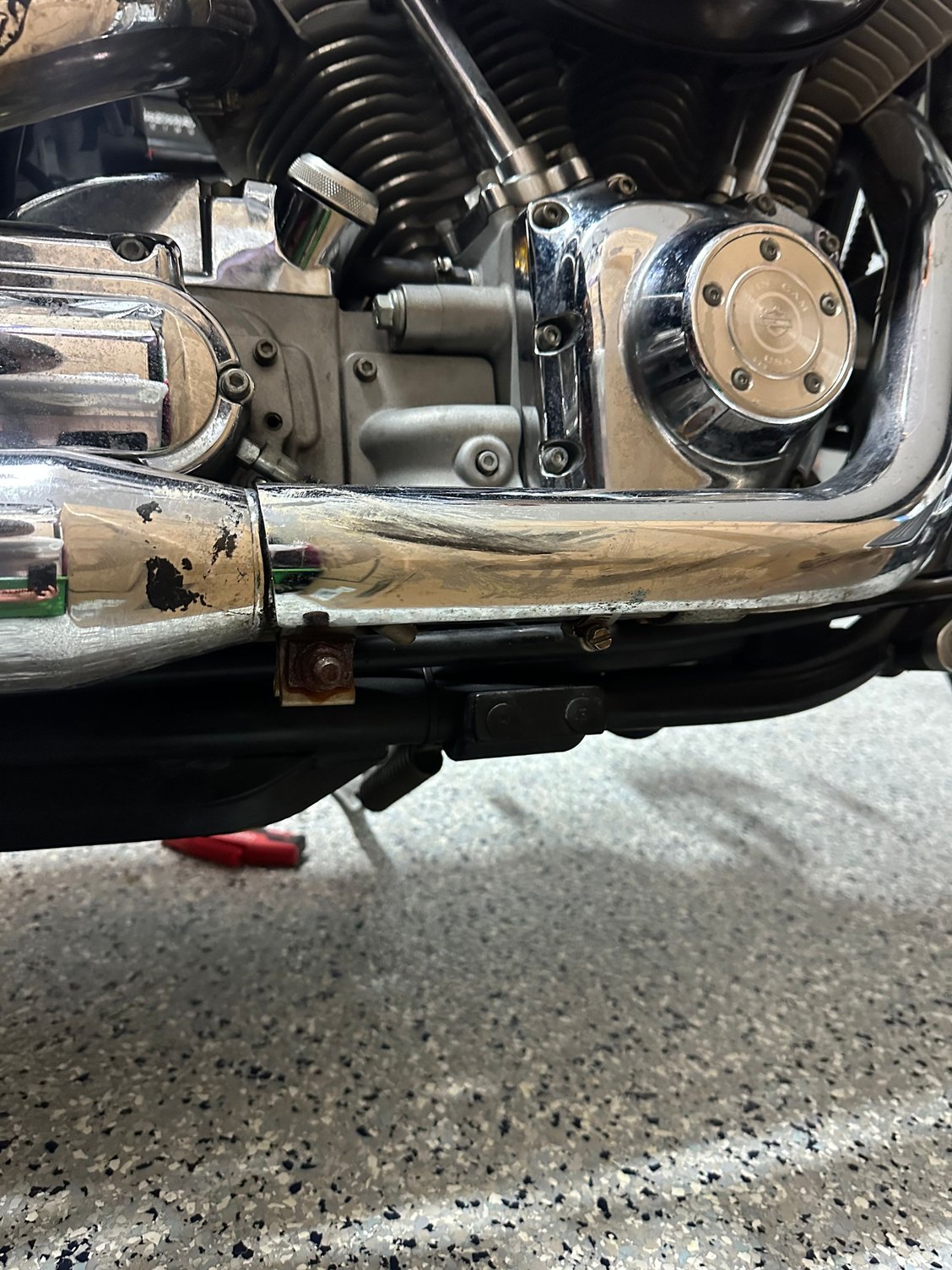

Originally Posted by randallissimo
If you are asking about converting to mid controls, show us the current set up, especially the primary cover.
Attaching a couple photos here, assuming this is what you were referring to? Seems to be in decent enough shape to me, what do you guys think?

Looks like your mids control shifter shaft lever is still there, and bolted to the base of the cylinder. It should be the flat metal piece under the bolt directly above the shaft in your photo. Remove the bolt and see if that piece moves freely with the shaft sticking out of the primary plate. This piece is what you will connect to the front of a new shift linkage. They can fuse up if left like that for very long. Mine did. If it moves nicely, you may be okay just being cleaned and lubed. . If not, it has to come out and be replaced.
I def got lucky, bolted a set of mid controls on and they went on (and shift) like butter. Thanks for the tips!
