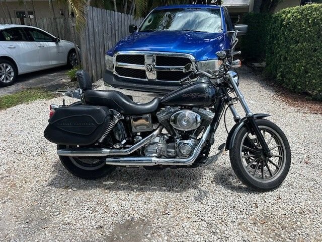

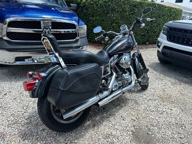

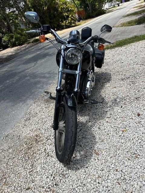

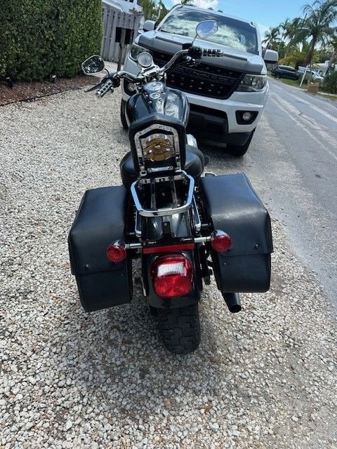

Now that my FXR King build is complete (for now), I decided to pick up an 05 Dyna Super Glide that I got for a good price in my area. Has 22,000 miles, paid $2500.
Considering it’s my first one, I did want to post here and ask about anything you dyna experts would be able to share with me as far as what to look for and be aware of. Definitely going to need some new tires, change all fluids, and likely some new brake pads.
Also, how tough is it going to be on this bike to switch to mid controls, the forwards feel a bit odd on this one to me and think I’d be more comfortable with a set of mids.
My final question for now is how tall, bar wise, have you all been able to go with stock cable and wire lengths?
Going to spend the weekend wrenching on this thing, removing parts I don’t want to run (bags for example), so keep an eye out on the classifieds section.
Here are a couple pictures from pick up day

Damn that's a good price for what looks like a good bike! Check or maybe even convert the cam chain tensioners to the '06 up style. Even at that low mileage the stock ones may we well worn.

If you are asking about converting to mid controls, show us the current set up, especially the primary cover.

Regarding a Mid Control swap, it looks like you still have the original Shifter Shaft in place. That will make the return to Mids much easier
