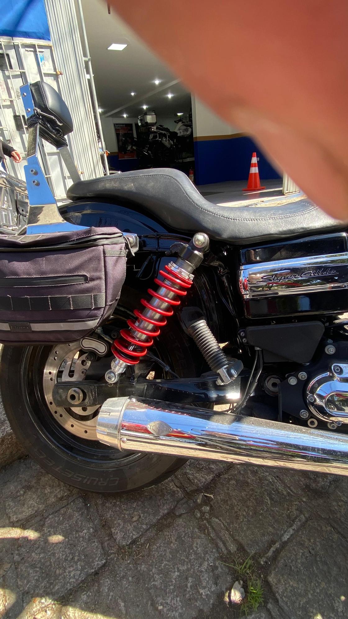

Originally Posted by HDTom
Not saying this is your problem but I recently went crazy searching for the cause of constant clack-clack knock over any little bump in the road. It felt like it was coming from under the seat but sounded like something was hitting the bottom of the gas tank. I looked at motor mounts but all seemed good and I can't tell you how many times I tried to shake the gas tank which always seemed to be tight. Then a line backer sized friend of mine took a short ride, came back and said, "Your gas tank is loose!", and proceeded to shake the gas tank up and down a good 1/8" - 1/4". Retightened the front tank bolt and all was quiet again.
YMMV but it's worth taking a good look at the security of your tank... and seat!
Good morning, I already checked it too. The bike looks like it's going to fall apart lol.

Originally Posted by Bubba Zanetti
As mentioned above, check that the gas tank bolts are tight. Also check underneath the tank for any wires, cables, or looms that are bouncing around and slapping the belly of the tank.
I would also see if the new shock is contacting the belt guard.
Yes, it does. I've already tried adjusting it. Today I'm going back to the originals and see how it goes.
You could use some big washers to shim the shock out a little, or do what I did and remove the belt guard.

Problem solved, it was a lack of pressure in the shocks. They were under 50 psi, so I added 100 psi and it fixed it. But I'll still replace the mounts just in case.

Wow, I've never heard of a set of motorcycle shocks that required 100 PSI!

Make sure the bottom of the shock isn't hitting the exhaust. Put it on a motorcycle jack and with the swingarm fully extended, look at the bottom bolt and exhaust.

100PSI seems extreme.

I also thought it was a little too much. But the company said they can handle up to 200. Anyway, I'll change the mounts, there's a lot of vibration on the handlebars. Should I go with the originals?
