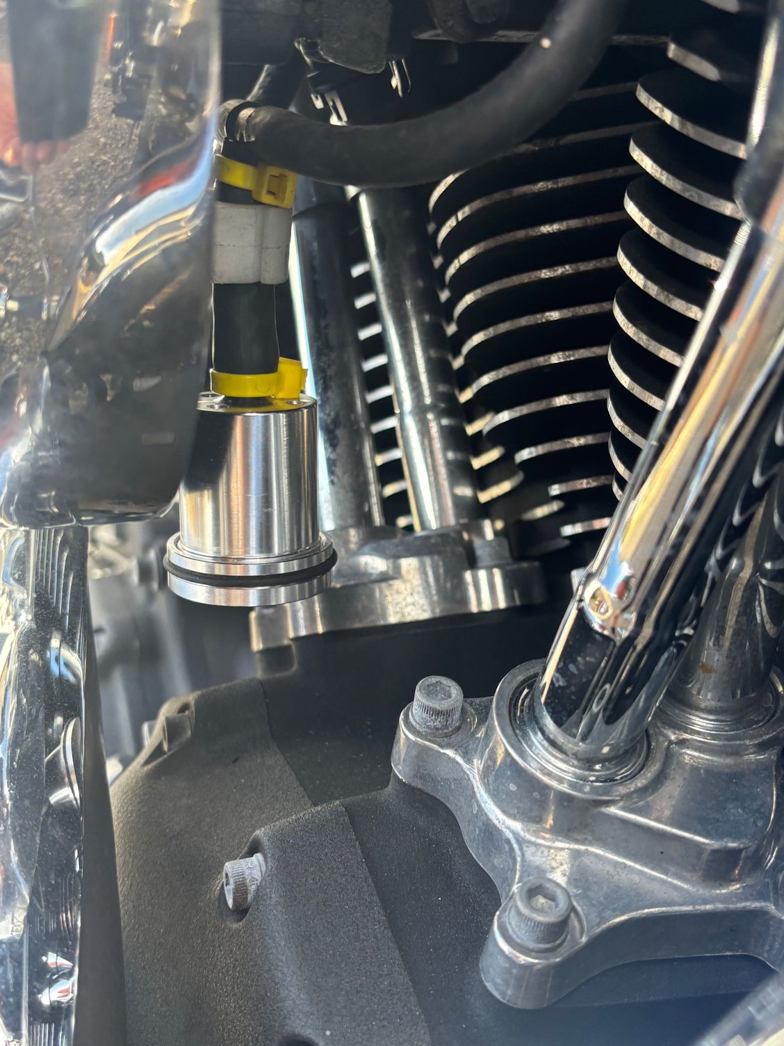

Hi Rodent66 yeah I was surprised not to get oil in the catch can as my oil level is above the hatched lines when cold.
Here’s the catch can I installed, I could not find black cable ties

Change yellow to black.
what is the catch can brand?
Yeah I will although you cant really see them to be honest.
the catch can is actually an aluminium brake / clutch master cylinder reservoir from eBay
