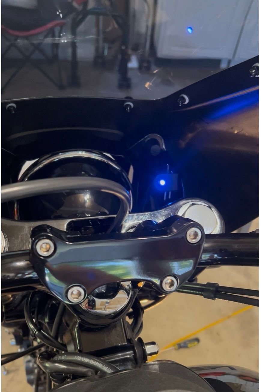

Did an ultra cool on my 107 and a mates 110. Had high temps, 260’s in slow traffic, mates factory 110 was a bit hotter.
After installing when stuck in town the unit picks, after a few miles of 45+ mph it’ll drop out. Last summer the hottest temp with IR after shutdown was in the low 230’s. The blue LED is cool, hid in faring. Also added an M8 filter, the cooler fitting provides the additional clearance. Units are nice and work well if you have the room and don’t mind the look.

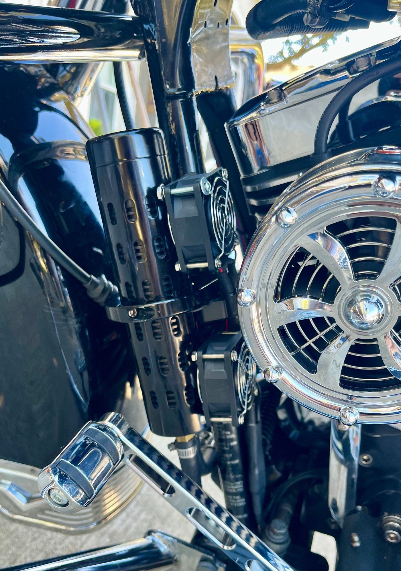

113” EVO in my Road King. It was 230-245 in traffic. I added an oil cooler, added fans to the cooler, then also added fans at the cylinders. I use to have them rigged so fans ran with the brake light thinking they’d run when I’m in traffic cause I’d be holding the brake.. but I stopped that and just run them on a toggle switch.
Together they do bring temps down pretty fast. Like over five minutes you can see the temp drop about 15 degrees.
I went CHEAP. Like eBay cooler $50, Market place luv jugs $50 or $75 can’t remember. Amazon exterior water rated computer style high cfm fans $18.00.
Buying a used oil filter didn’t bother me. I ran gas through it, sealed and shook it with gas… like 20 times.. flushed it a bunch. Blew it out with compressed air a bunch. I feel confident nothing was in there. It’s worked great and the motor has stayed clean. I cut the oil filter apart every other time and I change my oil a lot sooner than needed just cause I can. About every 2500 miles or so. I use Schaffer 20/50 except middle of summer and then I run straight synthetic 50 weight.
