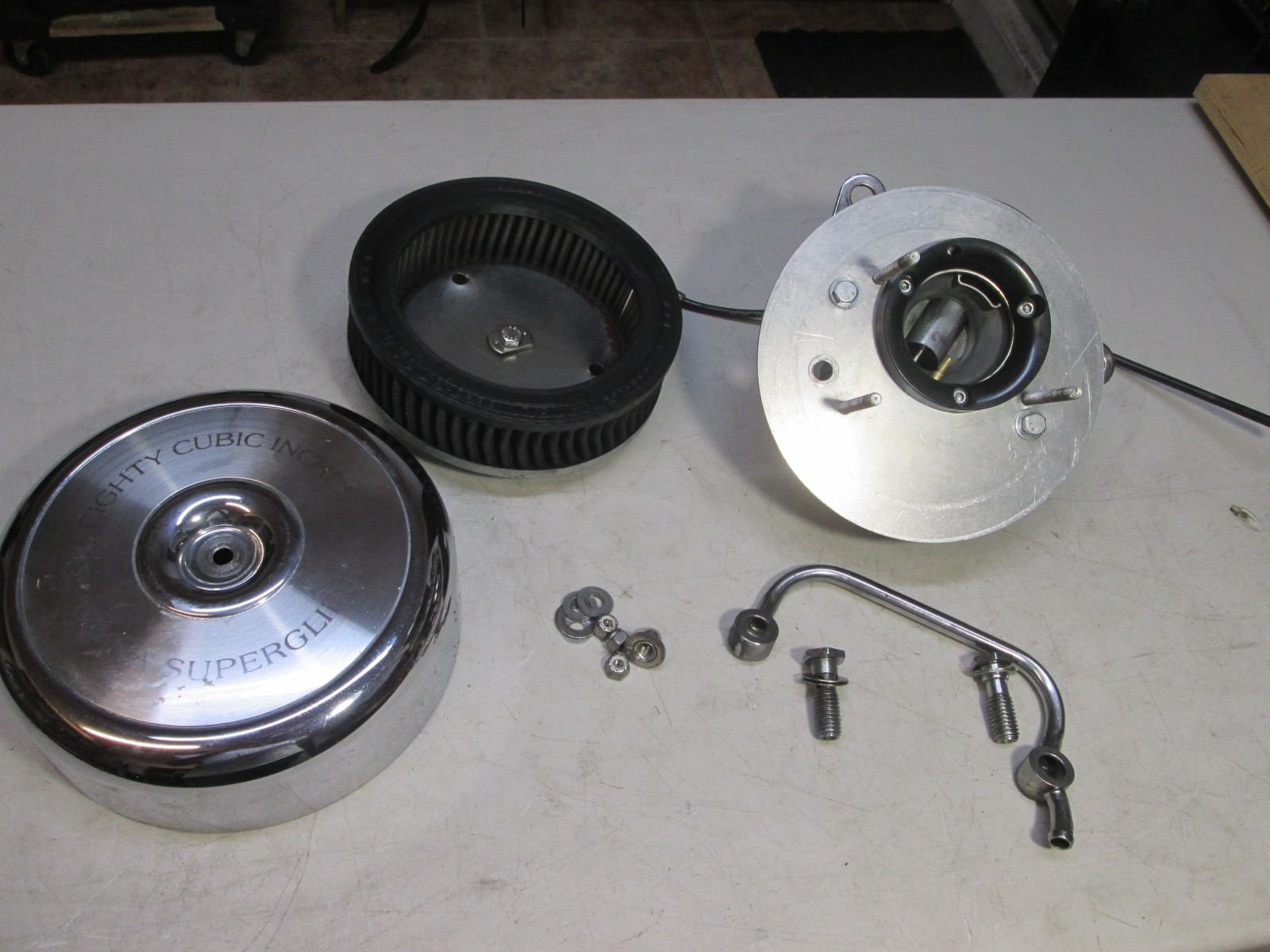

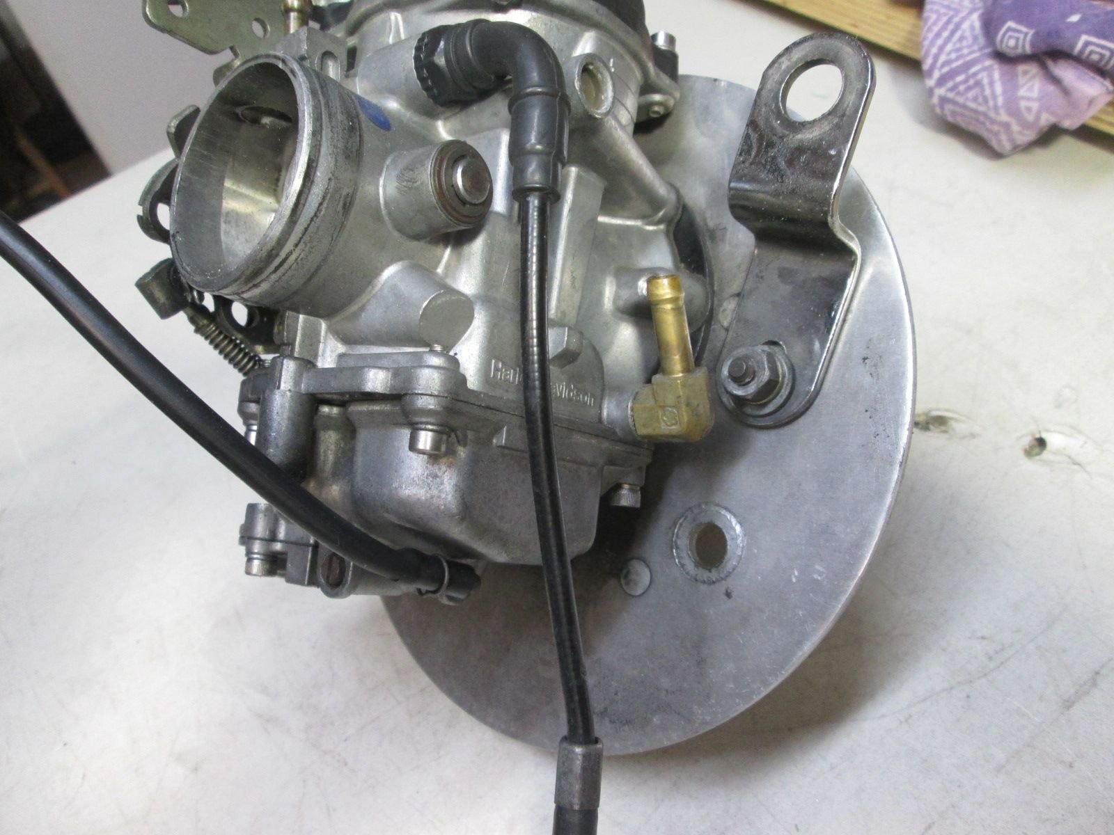

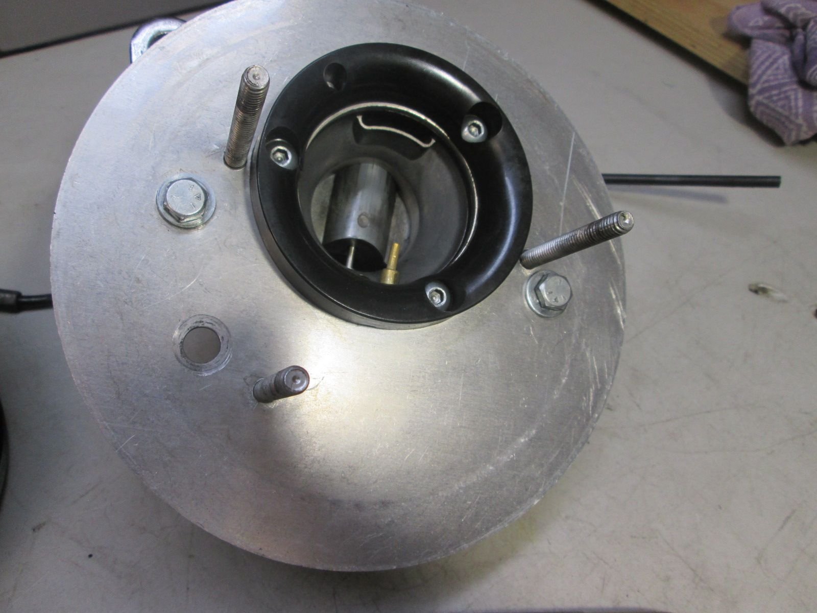

This intake is on a 96 Dyna with stock CV40 carb. The can is stock of course, the filter is K&N, the breather bolts and crossover pipe are nicely done, and the base plate is crude, almost looks homemade.
What is it?

Most of it looks like the same set up on my 95 Dyna, but you're right about the backing plate. It looks different.

It's a Screamin Eagle hi flow air cleaner kit. Harley sold many of them in the 80's and 90's. They are a simple design that works well.

Well enough to support Stage two? I am not a fan of uncovered air filters or the cone shaped suckers, I prefer the original covered system in the heavy rain I can get caught in down here in SWFL. So this leaves not a lot of options as far as I can see to improve on the factory set up.

Yes.

Yes, even enough for a 44mm cv carburetor on a big bore stroker engine. If you use the stock air cleaner cover rain is no trouble. It's simple and it works very well. What's not to like about that?

Yes! That IS what we like, so look no further. Thanks for the guidance guys.
