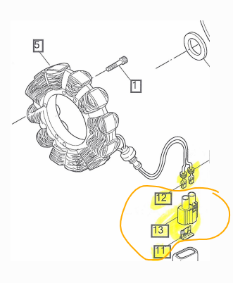

Anyone know where besides Harley to get the 2 pin waterproof stator plug-in that goes on the stator side, my new Stator did not come with it and my old one burned off. Harley wants $50 for the plastic housing (#13) and another $17.00 for the piece that holds it together (#11) Geez Louise, come on Harley, ya already make your money on the bikes, at least ya can give us a break on 2 small plastic pieces, come on. I see no where that has this plug seperate but HD i see why my friend has the saying "F**K the Factory" for HD prices are way too high for stuff

If you have the service manual you can figure out what type of connector it is (Delphi, Deutsch, etc) and then you can find any number of vendors on line that will sell you the parts for realistic prices.

yeah no manual on this bike, gonna try amazon for these maybe

Is the other side molded into the regulator? If it's on a pigtail, just find another two pin connector that can handle 30 or 40 amps and replace both ends. Make sure it's weather proof.
