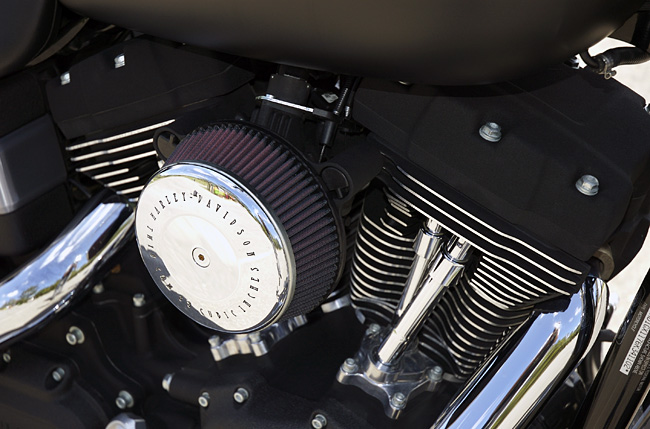

I've seen the picturesof the wrinkle blackrocker covers on a Street Bob andI'm thinking that might be my next mod. I'm wondering what it would take if I wanted to do the work myself. Any help from those that have tackled the project?
