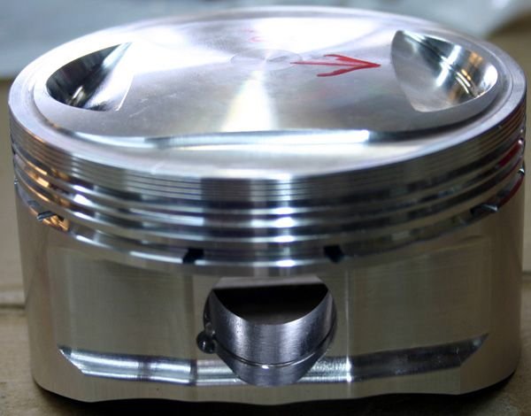

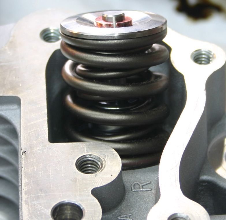

Clark asked about which pistons and cams I used
when I built my 95" HeadQuarters motor.
It's a monster with DougMagic.
Cams are the HQ-TC-600.
Pistons are CP 11:1.
High Velocity porting of stock heads.
etc
Idling it does sound like a hopped up small block Chevrolet.
Hitting second gear hard it does one of two things -
spin the tire so hard the rear wheel tries to pass me on the left,
or, if it does get a grab, it feels like both wheels come off the ground.
Usually it's the first scenario, and I shift to third as soon as the shift light comes on.
With the rev limiter set at 6500,
this monster is still pulling hard when it does hit 6500,
in every gear.
First three gears, it hits the limiter before you even know it.
That's why I set the shift light at 6000.

Hey Mud, what is the part # on your CP piston box?
they offer 3 pistons based on a 85 CC head. a 9.5,10.1, and 10.5.
the dome volumes are 4cc, 9cc, and 12cc. respectively.
My heads are at 82 CCs now, and I have the 9.5 piston to get 10.1.
Your cams are chain drive?

Pistons -
I'll go out to the shop in the morning and have a look dd.
Cams, yes they are chain driven.
mud
ORIGINAL: mentor70

dyna,
The HQ componentsfor top end and cams,
including head gasket, but less the other gaskets - 2200
other gaskets HD - 50-60
I also used the Barnett extra disc extra plate package
with HDScreaming Eagle spring - around 200
You will also want a good exhaust - 5-700
The cheap part was my own labor forassembly 8-10 hours @ $0
mud
