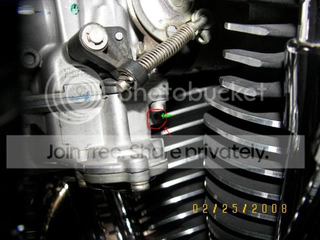

you can look at the bottom of the carb and tell if it has been changed out most of the time.
look on the bottom of the carb and you'll see an area looks like a straw on the bottom of it the factory puts in a metal slug if it is still there then it's stock from the factory. to change you can drill it out but when i changed me needles out there is a small hole on the side that you can stick a small allen wrench into and apply a little pressure and the slug will pop right out.
looking from front of bike red circle is area, green arrow is hole where i used allen wrench to pop out slug where red arrow is pointing hope this helps.
Old Feb 27, 2008 | 08:40 PM
moblmowr's Avatar
moblmowr
Joined: Feb 2008
Posts: 123
From:
Default RE: Another dumb question
yessir that helped a bunch. gonna take a look at that this weekend. thanks!
