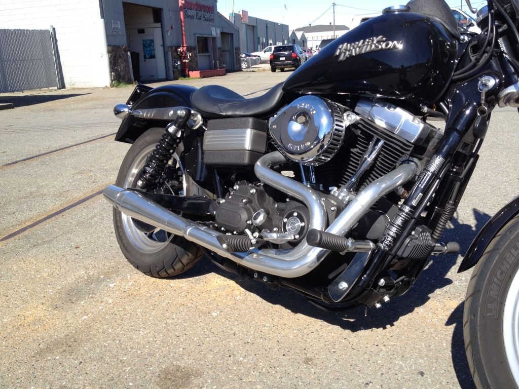

Ceramic coating is what you're after. Cerakote is a popular brand and a good product. I had my pipe twisted and coated, here's the result (could also have gone black, but I wanted silver):
