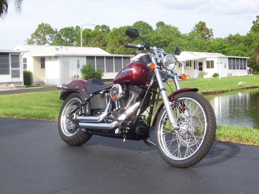

This is an age old question!! Just my 2cents here, I have a 2008 Night Train, Short Shots, SE/AC, XIED's. Been running the XIED's for 11000 miles now with just over 13000 on the bike since buying it in March 2008. I live in south Florida, elevation 12 feet above sea level, just got back from round trip ride to Sturgis (5600 miles in 13 days). Not a problem, nada, bike ran super. Ran cool in traffic, and I did alot of crusing at 75-85 for 100 miles at a time on interstate. Give Nightrider a call (# on web sight). Super guy, lots of info. Again just my 2 cents, but I am sold on XIED's.
