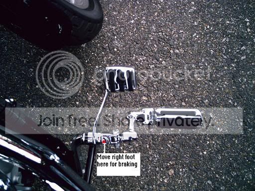

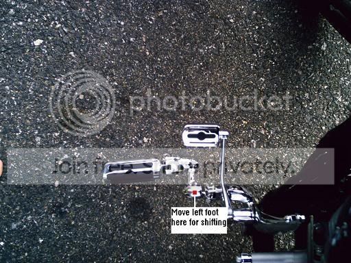

Originally Posted by Road Pirate
I'm 6'2" with size 13 shoe and ride an '07 fxdwg with forward controls. When riding I have to angle my feet outward to avoid controls. after a while it is very uncomfortable. toying with the idea of some kind of peg extensions or footboard. Any suggestions would be great. Thanks and ride safe.
Perhaps the attached peg extender V-Twin P/N 27-1643 could be obtained from Discount Cycle Parts.com to allow you more room at the end of your peg to rest your foot without contorting it.
On the shifter side, you might consider re-positioning your shift lever. Remove the pinch bolt and slide the lever off the spline; rotate clockwise about 5 degrees and re-attach. You could try a couple of iterations to see if you could get a position for the shifter that would give you more clearance under which you might rest your foot without contorting it.
Thought I'd throw a couple of ideas out there for you.
R/
Priest
