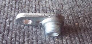

So, let met get this straight.... Do I need to get another one of these?
If so, does anyone have a part #?

yes you will need another one and the holes need to be drilled out a little. there is one on the left side holding the sig to the handle bar. I found mine at the local Harley salvage so I don't know the part #, but if you explain to the dealer or take the one you got in to show, I'm sure they could help you. you also might be able to find someone here on the forum that has installed a HD relocate kit and has one laying around that they don't need anymore.
and no they don't go behind the QR shield if you install them on the lower tree's, they are just below.
if you want a better pic of how they look when done I can post one tomorrow

Just a heads up, mine seemed to be hardened, I wound up taking a round file I had and making the hole bigger, not as easy as drilling, but not much work.
the jp relocation gooked good as well, but when i was looking it was not in stock, so I went this way, easy mod.. and cheap.

I ended up using these....
http://www.dragspecialties.com/fatbook/14/462/7723083
They worked good and look good, but the didn't come with instructions. I found this link on the net that shows well how they go.
http://ae1m.com/relocate_directionals/install.htm
The nylon washer between the bracket and the blinker housing is a must. I used a little ingenuity to aquire some nylon spacers. I removed the nylon insert from a 3/8" nylock nut. (a 3/8" nylock has a 5/16" i.d. hole through the insert). Using a small triangle file, I carefully filed the crimp away from the nylon insert. It worked great.
