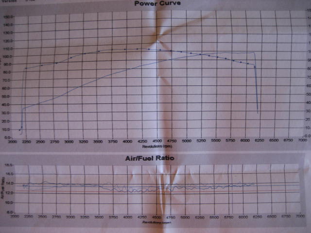

This is a pull made before gettin tuned on my current build & before break in (99hp & 104tq), did the pull to make a couple adjustments for break in riding. After break in & tune it makes 101hp &108tq. Can't find my tuned pull that's why I'm posting this one. T-man's 590 cams are 590 lift, Intake close of 44, Intake duration of 246, Exhuast duration of 248. Has a pretty broad torque curve & hittin pretty hard down low for a 95, after tuned it's at 100tq at 3,000 rpm's & carries nicely for fairly short duration cams. This was tuned on a very well maintained dyno star by a preffessional & very reputable tuner, he told me other dynos would show higher #'s, so I had our local harley dealer make a pull on it & they show 104hp & 112tq. Big #'s but I trust my indy so I go with his #'s 101 & 108
