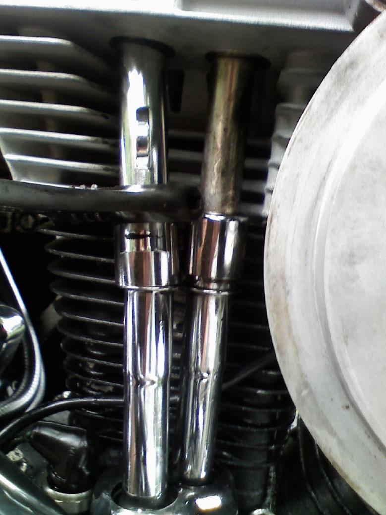

People at work were saying that it should work, ya'll are saying it should work, the dealership is saying it should work....I've got to be doing something wrong....
This is as close as I can get it. I'm about to start cutting the *****

It looks like the lower tubes are upside down
Yes it does. Maybe that has something to do with it.

Yikes! That looks like your problem for sure! I do crap like that all the time!
Wow, they do look upside down.

Yup, definitly upside down.
