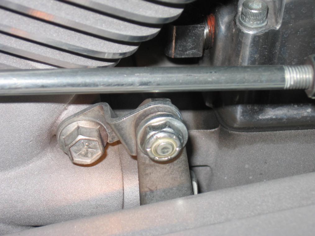

Originally Posted by Sonny's World
Could you post a photo?
Here's (see attachement) how the (mid control) shifter lever shaft retainer bracket is bolted to the engine on my FXD 2003.
It's the "Retainer bracket, shift lever for 2001 and later models" p/n 34639-01
from the Floorboard kit 50601/01.
There is second "Primary shift lever retainer bracket" which is used on 1993-2000 models.
The p/n for this one is 34639-93; it comes from the "FXD CHROME FORWARD FOOT CONTROL KIT" p/n 49080-03A.
The instruction sheets for both 50601-01 and 49080-03A are in the ***H-D Instruction sheets database***.

If you didn't get the shift lever retainer with your pre-owned kit, search for the instruction sheets data base and you should be able to get that required part from your dealer.
