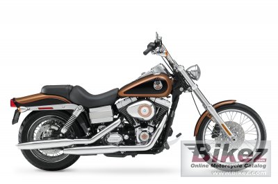

I just put 3 degree trees (1 degree more rake than the WG trees) on my 06 FXDI Super Glide which has 29 degrees rake in the neck. The front looks nothing like a Wide Glide because, like that long-haired hippie lookin' fellow said, the WG has 34 degrees built into the neck from the factory.
Here is a comparison of the total of 32 degrees on my Super Glide as compared to the 36 degrees on an 08' Wide Glide:
Below is a visual comparison of the total of 32 degrees on my Super Glide as compared to the 36 degrees on an 08' Wide Glide.
Use a rake/trail calculator and see if a combination of trees and raked cups will get you closer safely.
Also, look at bolt on chopper kits. Seeger is one manufacturer of these.
Other than that, open your wallet, dig deep, and have your frame cut to put rake in the neck.
