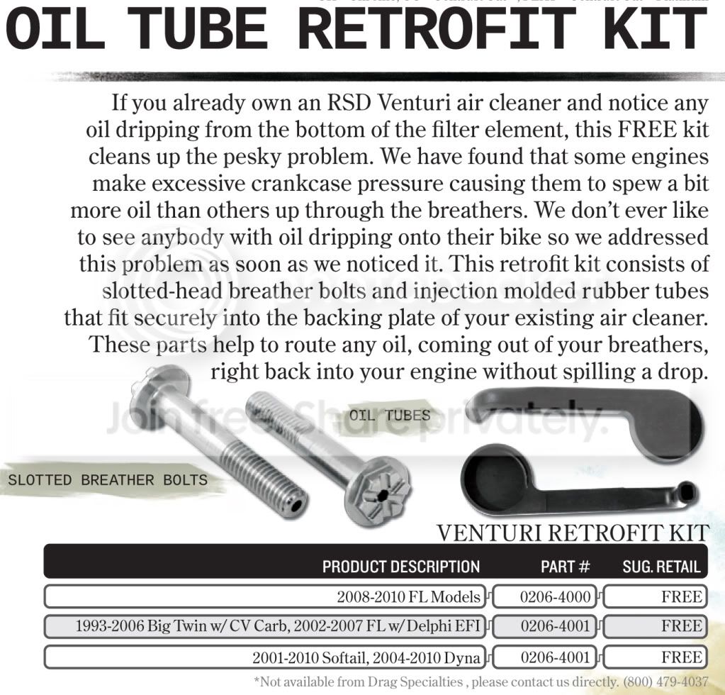

Hey Guys, new to this forum - new to any forum. Y'all seem to be a good bunch, with a lot of knowledge.
Gotta a 2010 FXDWG - not my first HD. My patience has run out on this stock scoot. Time to build her up. I've already pulled the trigger on the pipes and tuner - cams later. Question. A/C from Roland Sands have had drooling issues, I've been told. Before I make a phone call, any of you guys know if they've fixed this problem?

they upgraded the breather bolts and added rubber guides Kinda like the way the stock breathers work. Works great. The upgrade was free and all new intakes come with the assembly.

Get the FREE upgrade kit. Call PM to get one.

If you get a new kit, it will already have the upgraded hardware to prevent leaking. We haven't had any issues with the new ones we have been shipping for the last 6 months or so.

Big thanks to PM They are sending me a kit even though I never bought my breather from them, which saves me some pita because I got mine from an Ebay company, and I'm sure they came across the breathers in someone's old stock purchase. Again, thanks !!

Got the upgrade kit, put it on, and it worked like a charm!!
