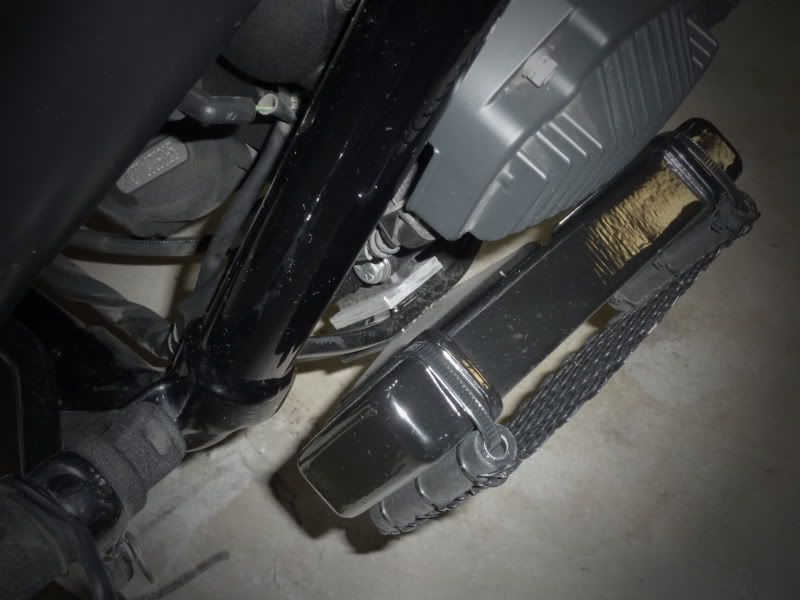

Red is for permanent lock like engine head bolts, blue is intermediate so thats what I use. It holds securely but allows for removal if necessary and green is for already installed bolts and nuts. Its suppose to wick into the threads. I've used it occasionally but blue is my first choice for almost everything. Here is a shot of my 1/4 in shim.
