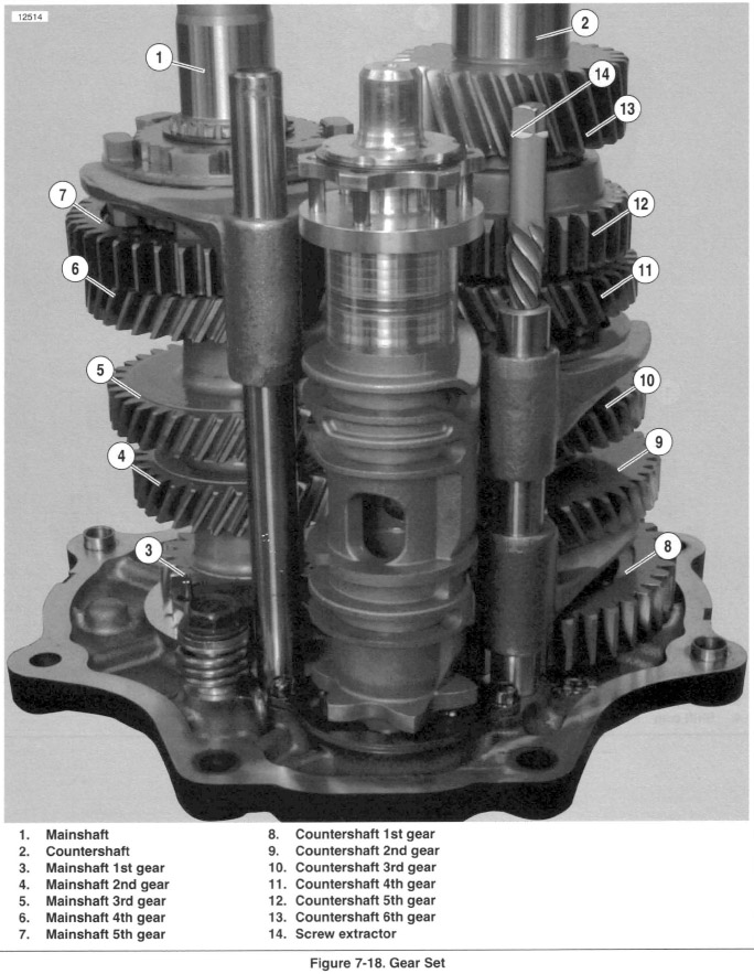

The transmission is constant mesh. The gear clusters are always together.
The input and output shaft has what are called dogs. Look between 1 and 7 and you will see them. Huge sob's.
They slide back and forth between clusters on the mainshaft and countershaft when you change gears.
You shouldn't have any trouble.
