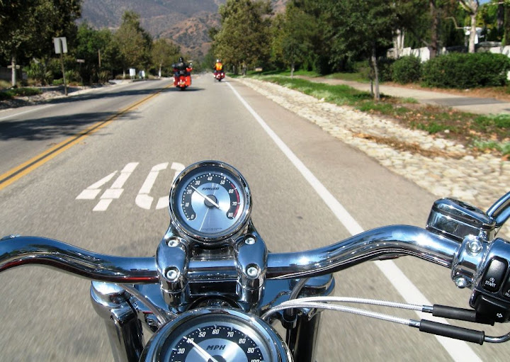

Three good ideas below. I was thinking of doing a Screamin Eagle Dyna setup (see last photos below), pretty much like bberck's and relocating the tachometer to the risers.

Originally Posted by Jimbo96
Here is how I did mine. I just cut off and milled the original risers so they were square with the clamp area. Then I cut off the front trim piece with a hand grinder. I milled them so they were about 1 3/4 inch tall. I used stock street bob cables and brakeline and my factory wiring harnesses were long enough. I have a few more pictures if you want to see them.
Originally Posted by bberck
Don't speak to that guy any more.
The street bob dash works on a low rider they use the same tank. I have a tank off a low rider on my super glide I went with the 2010 wide glide dash so I could move the switch from the neck.
If you don't want to lose the tach you could run a speedo tach combo. Several guys also just added some LED lights to the LR dash to replace the stock dummy lights. I even saw one guy mount the stock lights between the tach and speedo.
Picture of LR tank with WG dash

Originally Posted by rogue125
desilt,
the person moved his indicator lights to his dashboard. Between his speedometer and Tach.
I am doing this right now. I found some small LED's from www.detroitspeed.com
it is turning out to look good.
