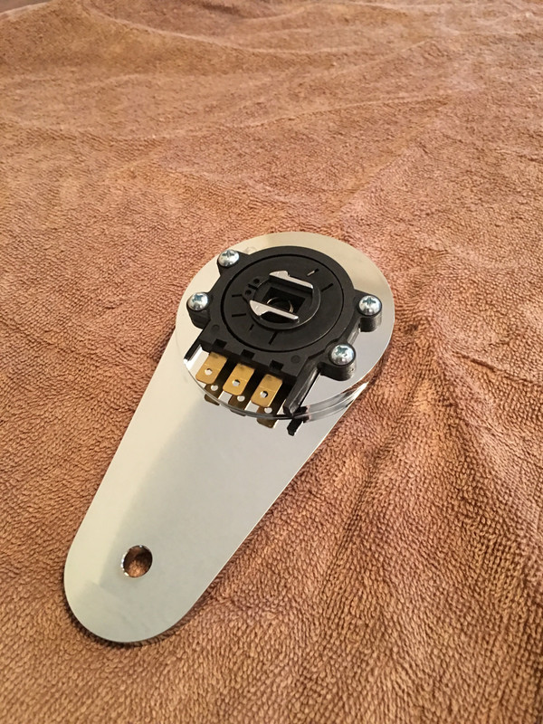

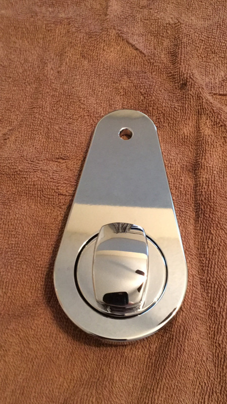

I'll repost since my picture link appears to be broken now too...
I know this thread is all about putting the switch in a console, but for those
of you that want to go the quick route in the horn location, there's a
switch/bracket combo available from V-Twin Mfg. I ordered one for
my OL's Sportster, then didn't use it. This is what it looks like.
The V-Twin part number is 32-0483
hth,
