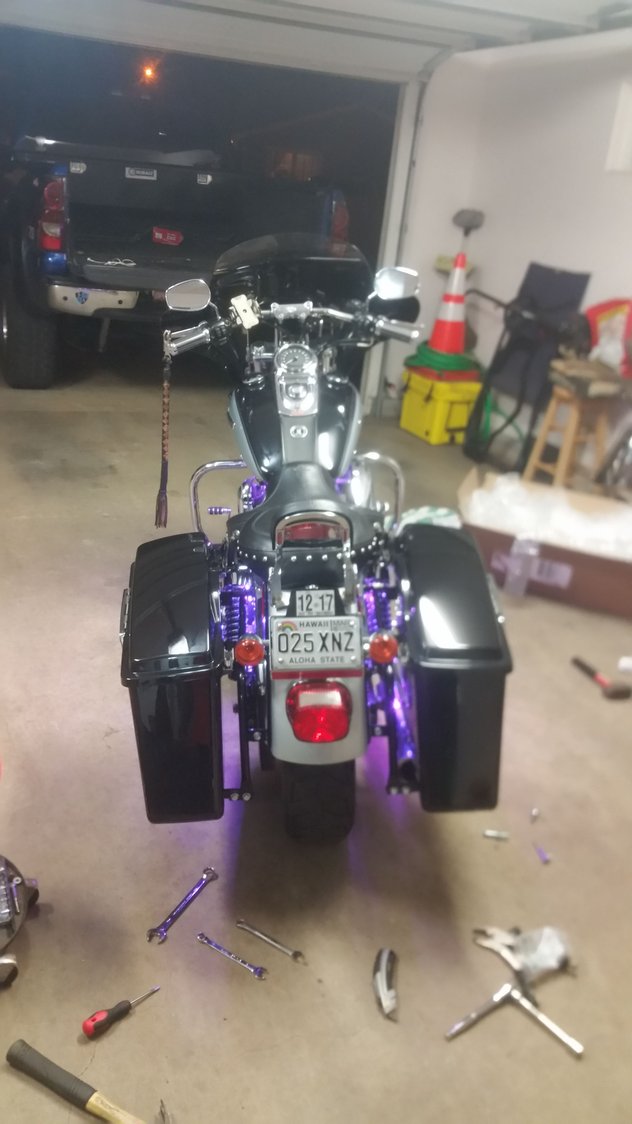

This was my install with a few simple mods...
I made some custom fillers .

What did you make your fillers out of? Could you shoot me a quick breakdown? Great looking bike.

i made my fillers out of a clear acrylic sheet from the hardware store, cut to size and heated it with heat gun to shape and painted the inside with black paint . I made some little brackets out of aluminum angle iron mounted to the bag mounts then screwed through the fillers..i had to drill 2 new holes through the bags to mount and added a couple spacers....
