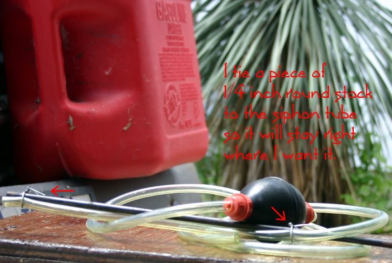

....if they are, look for pinholes. if not, you're probably OK here.....
....after I siphon all I can - I get the last little puddle out by sucking it up into a towel..

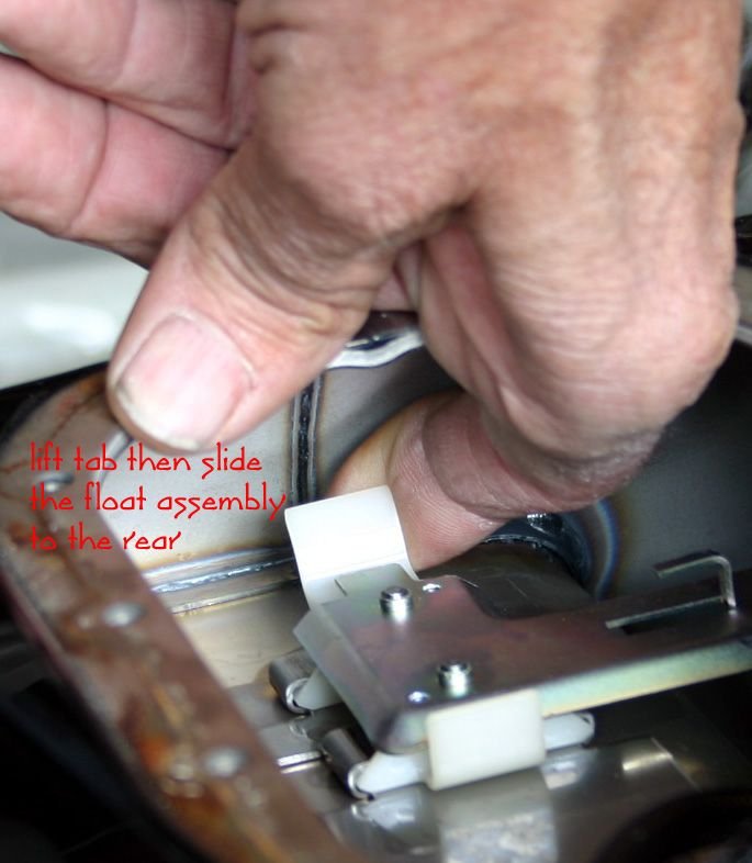

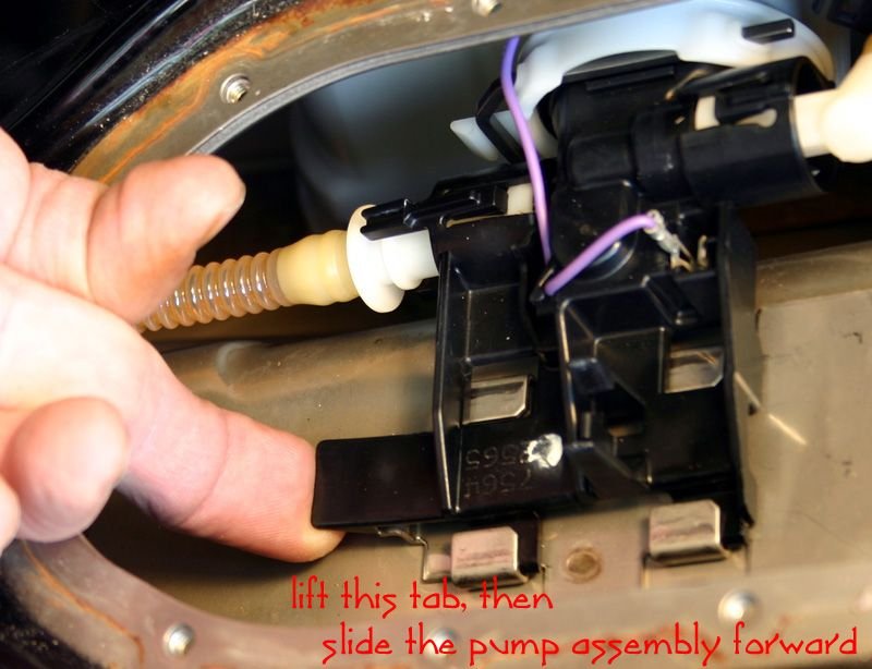

....now the fuel pump and float assembly is removed....
....above - easier for me to remove the fuel line by demounting the pump assembly first....

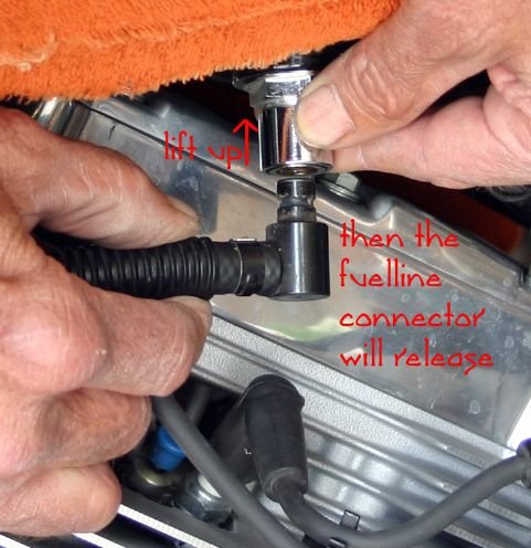

........next step - you see I am squeezing the two black lock tabs....

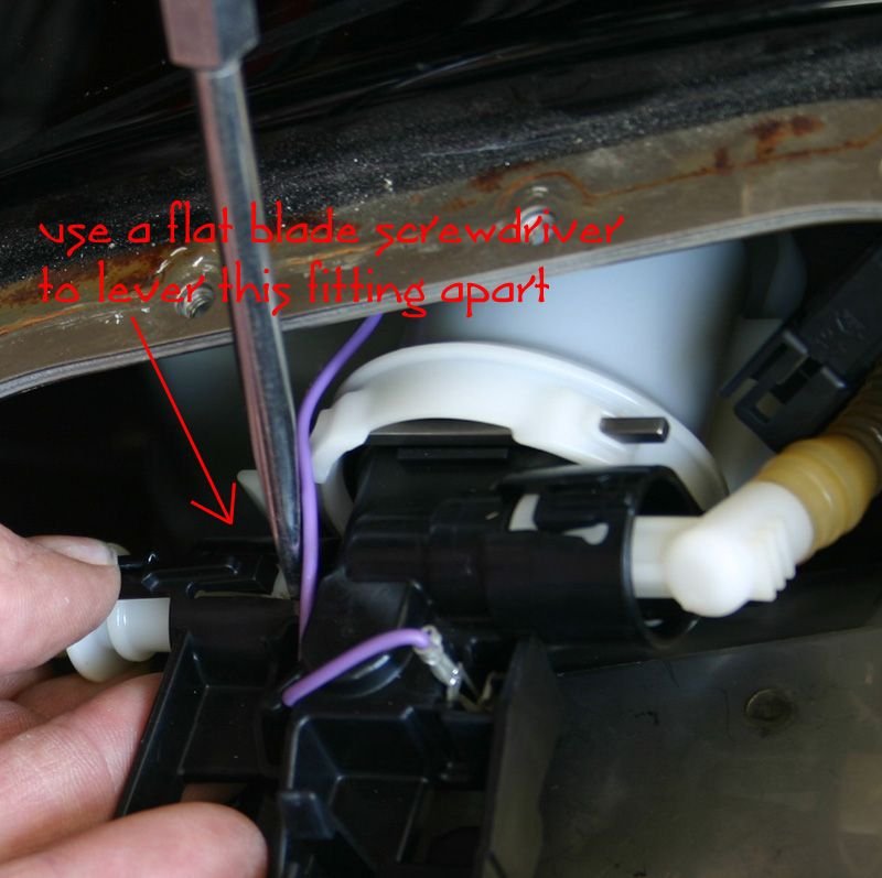

....the bottom one is always stubborn for me....
....don't rush it. lever GENTLY - if needed.........................

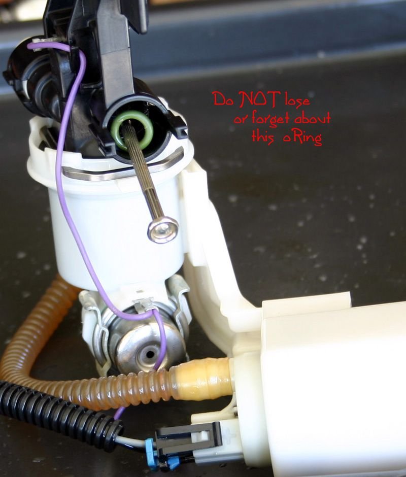

....green oRing below is the seal for the fuel line....
....components below are not unbreakable....
