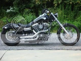

Burly's in rear stock up front. 2011 fxdwg
I also have a Wide Glide...
Do you ever bottom out?
How hard does it ride compared to stock?
My bike stands pretty straight up on the kick stand. Is it worst with the Burly's?
