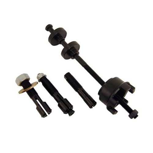

here are the 3 i stock
pit posse
Tusk bearing puller kit
and ol faithful... gets more bearings out than any of the $ ones!

can you give me a quick run-down on how the pit-posse works?

go with the last one man it is the cheapest... and flat out works the best! impact style or screw style removers i have i hate them! simpler is better all you need is the kit and a hammer save the $ and go with the last one... by the time one of the guys in the shop gets done setting up the other 2 i already have both out with the other bearing... very very rarely a race will shatter.... then we weld a bar across the race and pop it out
