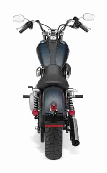

Did he explain how the dash is different? I do not see any difference between an 07 and an 09 dash, first pic is 09, second is 07.
