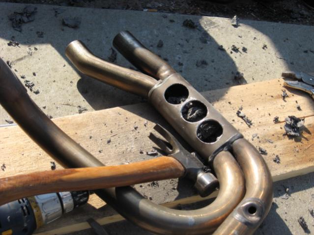

Originally Posted by izzyryder
I had the same exhaust on my 2010 fat bob, and there is no way to get rid of the cat other than pulling the entire exhaust.
Bull Pucky, this is a 2012 FXDF pipe, re-welded with a piece of marine grade stainless after Bi-metal hole saw surgery. Others have done it also, and much nicer looking than my hack job. This pipe works great now. However, the OP can go this much easier route and just switch out his '12 pipe for his '08 with this kit:http://www.phatperformanceparts.com/.../1861-0594.htm
