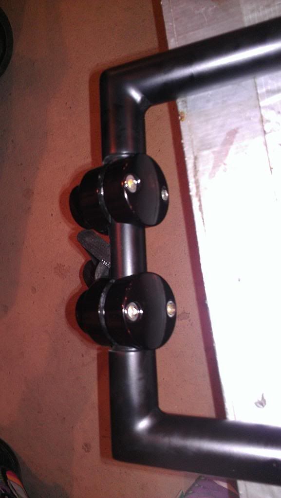

I also have the wild1 chubby outlawz. You wont be able to get completely round ones like the ones you have posted because the mounting area is only 1 inch then goes up to 1.25 inches for the rest of the bars. the mounting area isn't wide enough for the round ones and even if it was it looks like crap with the round riser up against a flat edge. Here is a pic of some I bought like those above thinking they would work.
With them mounted like this inside of the 1 inch area they are about 3/4 of an inch too far in to bolt to the triple tree. So now i'm trying to sell those and picked up a set of these to powder black because I wanted 2 inch risers http://www.ebay.com/itm/HANDLEBAR-RI...684#vi-content
But this set here looks to be exactly what you would be looking for http://www.ebay.com/itm/BLACK-RISERS...632#vi-content
Learn from my mistakes and don't get the round ones even though they look cool, they'll only work on 1" bars
