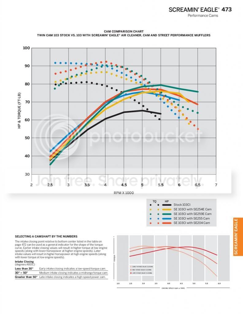

Originally Posted by jtp1984
planing on going with the se race tuner when i do the cam.
In that case you can save yourself a lot of bother and go with some SE cams.
The problem I have always found with cams is getting a good tune to match. Not only do you have to get the fuel right but its even more important to sort out the timing to match the cams, something which is sadly often overlooked and this ends up leaving HP on the garage floor.
With your planned SEPST you will be able to load a canned map to match your stage-1 bits plus the cams. You will then be 95% of the way there. You could just do a bit of Smart tuning if you want to bed them in even more. No real need to mess around with a dyno tune unless you want it really tight.
Plus, there is absolutely nothing wrong with SE cams. There's a good range that's easy to understand and they all work really well. Some people think that fitting another brand is the way to go just because they are non-Harley, well can't say I agree.
Pick some from this chart that gets you best power in the range you want it. From what you said I'd think 204s would do you nicely. Makes the bike sound real nice too.
