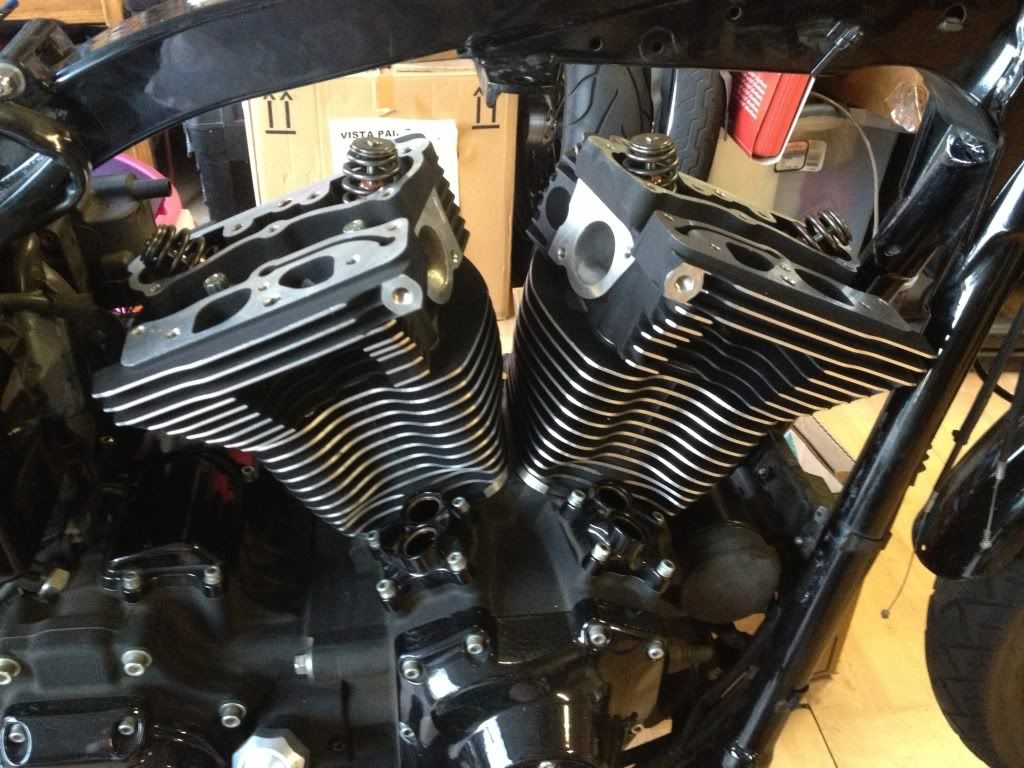

***updated***
I got my heads back from Wink Eller, they look good but like I said its only mild headwork as its what I could barely afford.
I installed the pistons and cylinders tonight and checked the deck height, they were at a solid .010"
im tossing the idea of running a .030 head gasket vs the .040 gasket that came in the big bore kit. anyone think its worth the extra 50 bux?
Its a hell of a lot easier to do it now than to do it later, but you already know that.

**UPDATE**
well I made some progress the last two nights, ive only been getting about an hr a night to work on this but I should have it finished and running thru heat cycles tonight.
I installed the heads and ended up using the .040 gaskets and not the .030 gaskets(long story)
installed the rockers, push rods and throttle body, tonight ill be connecting all the wiring, tank, exhaust etc and fire her up. I ended up selling the quarter fairing and will be running the rifle again until I find a decent fxdxt fairing.
