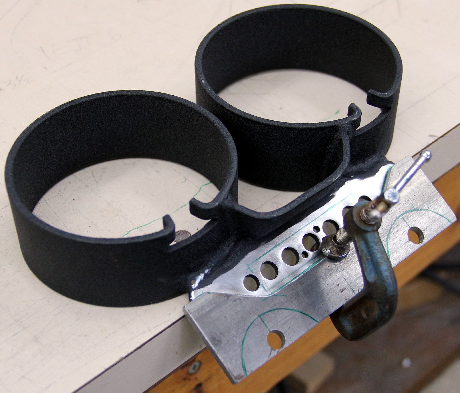

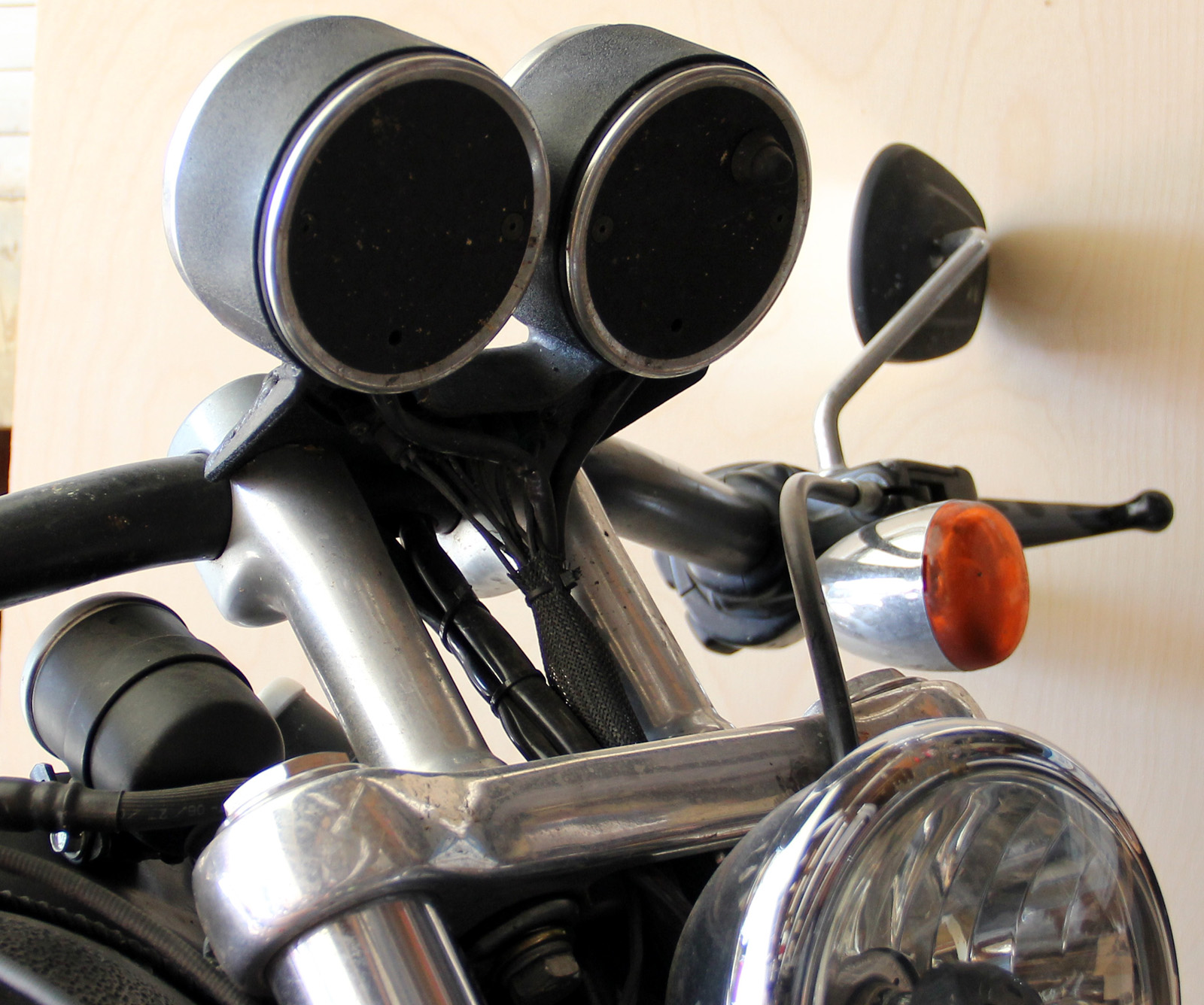

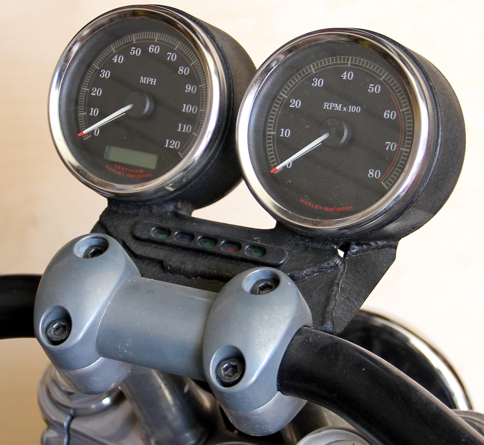

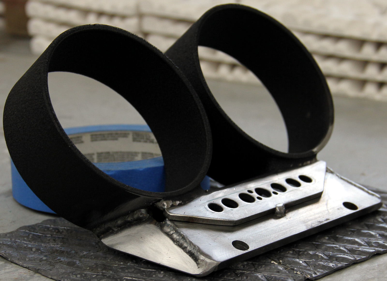

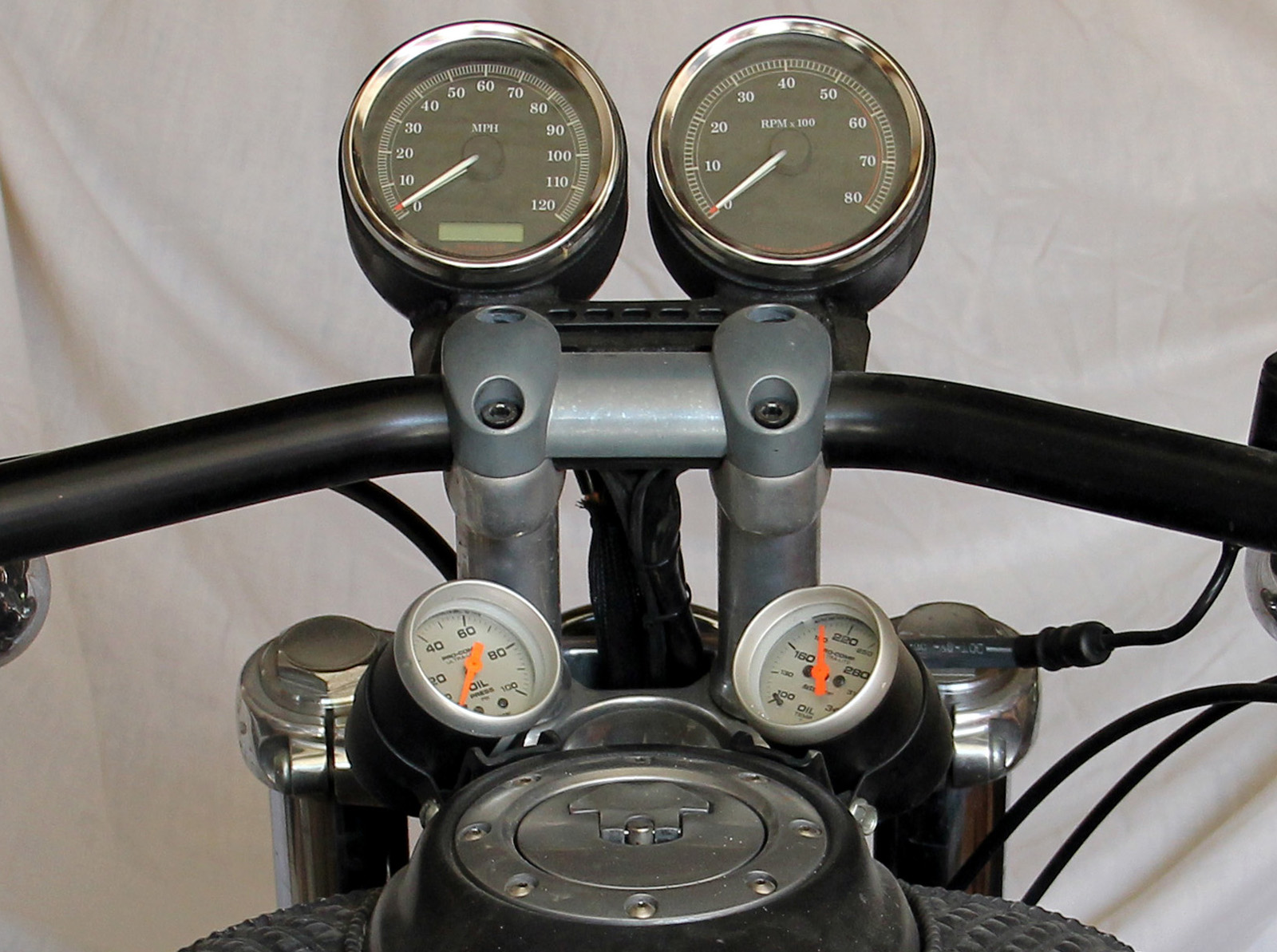

the main issue with this technique is the speedo mount.
on the bars is the ideal position for the speedo and tach.
a glance outta the corner of your eye and you know where you stand.
I built a speedo/tach mount.......
