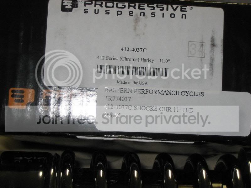

Default RE: measuring twice - 412 question
You need to measure between the left side front of the rear fender and the belt guard thats where itusually hits, Not the tire clearance.. Maybe this pic will help
[IMG]local://upfiles/24219/5464D8D3375F422CB6C6D5A3C21556D2.jpg[/IMG]

Thanks Trotter, and everyone else that replied. that helps a ton. I can always run the heavy duties on a light setting if I need to.
