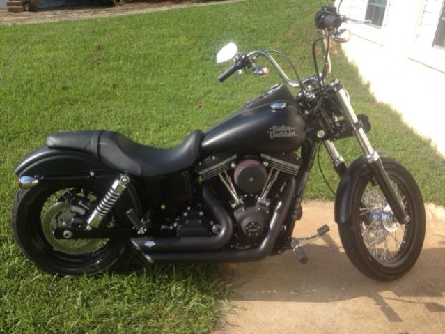

hi all,
So I put short shots on my 13 street bob 103, followed by an arlen ness big sucker stage 1. so I went to Harley and got the stage 1 download. I am not really wanting to spend 5 or 600$ on a tuner so they told me if I wasn't riding across country or doing anything else to the engine (which I am not) then the download would do fine to fix my air fuel mix where it should be. on the way there with exhaust and breather on it ran pretty good crackled and popped a little bit when deaccelerating. after the download I have rode 50 miles or so and the acceleration is better but the backfiring is deacently worse and when maintaining a mid range rpm in a lower gear it feels like every 2 or 3 seconds it hickups a little bit. so with that out of the way... I didn't change out the gasket at the head of the short shots when I bought them cause I only had 200 miles on the bike. would that be the problem? or should I contact them about the download or take it off or what? any advice appreciated thanks...

it isn't running hot. if I get around 3000 rpms when I shift it will throw some back fires out. I am more worried because if I am holding say 2300 rpms going down main street, every 3 seconds or so it will feel like it misses or hickups. I don't know if it is loading up or starving for fuel. and I figured that combined with the back firing means it is running lean.. I don't have a lot of experience with efi. I would want an adjustable tuner but like everyone I am on a budget and the way they described the download made it seem like it judged my air intake and out and adjusted the fuel accordingly but It seems to me more like it is just a set thing where it turned up the fuel a little bit. kind of funny tho cause it ran better before the download.
