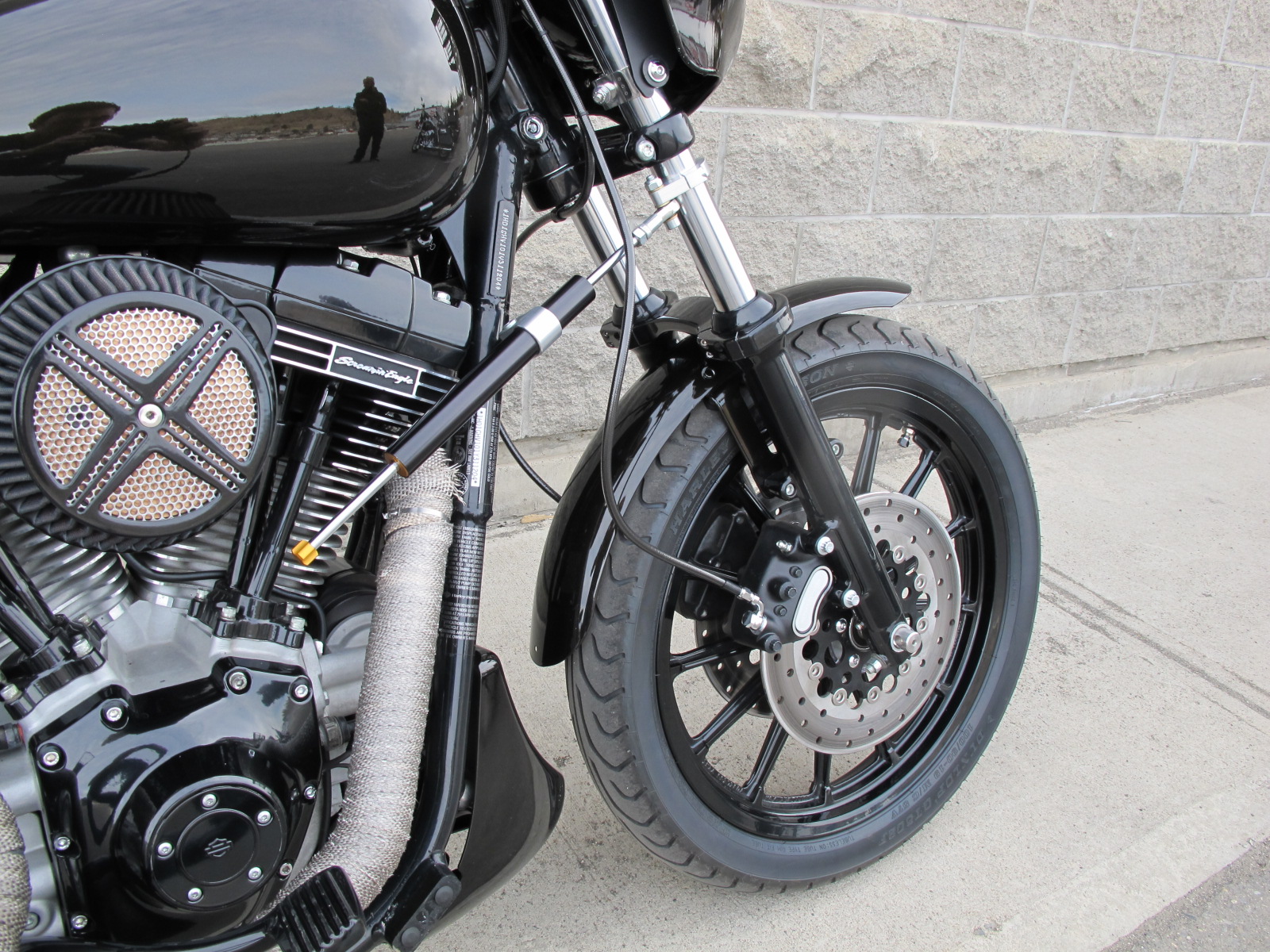

Bought a fork brace on eBay...49mm fits Dyna and Vrod. I go to bolt it up and there is no way the piece will fit straight across without hitting the fender. It doesn't line up as low as it's supposed to.

You got Vrod sliders on that dyna frontend...yes? I think your problem is that the fork brace is for a Vrod and a dyna, but not Vrod sliders with a dyna fender. I think those vrod sliders are shorter than the dynas. The difference in dimensions is above the fender mount. So that's why your dyna fender sits higher in relation to the top of those Vrod sliders. Take a look at any good photos of Vrods and dynas, look at those fender mounting bosses in relation to the top of slider, look at the difference in length of the fender mounting brackets...you'll see the difference. Do you still have your old dyna sliders?...compare.

God damnit you're right ....totally forgot I swapped em when I did the dual disk. I'll toy with it and see if I can bring the fender any lower, otherwise, no brace =(

Dropped the fender a little and it fits just fine, thanks boys.

You're right:
