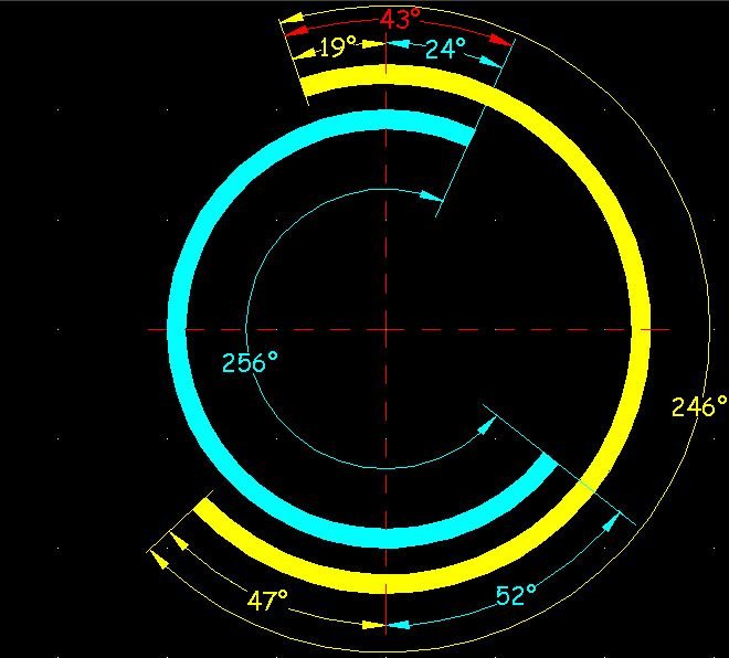

everything you mention above.
but, you don't mention *hardest hitting and most bang for the buck*.
if we add that to the equation - HeadQuarters.
before I went to the 121 inch HeadQuarters build, I built a 95 incher.
about 2500 for parts
(bore cylinders to fit their CP pistons, Hi Velocity headwork, and cams)
key to *hardest hitting* is compression.
11 to 1 is the HQ answer there.
Cams are the HQ-TC-600.
Pistons are CP 11:1.
High Velocity porting of stock heads.
etc
Idling it sounded like a hopped up small block Chevrolet on alcohol.
Hitting second gear hard it did one of two things -
spin the tire so hard the inertia at the rear wheel tries to pass me on the left,
or, if it does get a grab, it feels like both wheels come off the ground.
Usually it's the first scenario, and I shift to third as soon as the shift light comes on.
With the rev limiter set at 6500,
this monster is still pulling hard when it does hit 6500,
in every gear.
First three gears, it hits the limiter before you even know it.
That's why I set the shift light at 6000.
