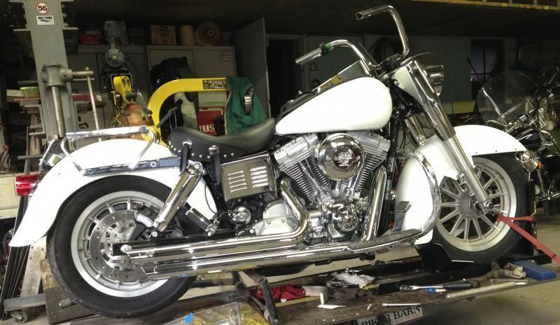

Nothing for the 49mm forks other than Switchback front end. Others have tried the FL Softail front end with the aftermarket nacelle but were never able to get the headlight adjusted due to the rake difference.
The 1960-84 FLH triple tree will fit with 41mm forks. My father did that on his 2005 Super Glide ( now a 80/80 FLH clone)
