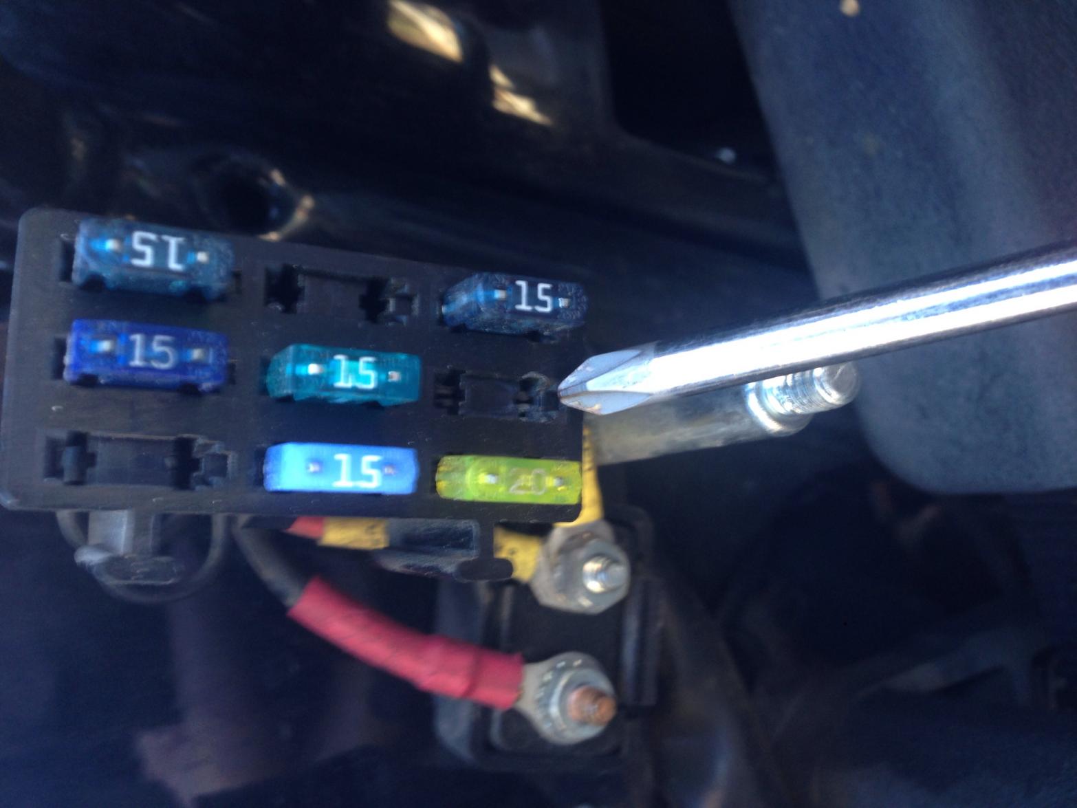

holy smokes, I just noticed it's blowing this fuse, wish I would've looked harder last night. I don't have the manual on me, it blows when I try to start bike, any ideas which it is and what causes that? (15 amp)
It blows right when I switch to "Run" not when trying to start

While not directly related to your issue, I was having a helluva time with an electrical gremlin. Finally took some time, and traced out, and pinned out all my wiring. Found a loose ground terminal receptacle, in a plug in the harness. The pin from the opposing plug, wasn't making good contact. Intermittent power issues with the left side marker lights. Drove me nuts.
Can't see in the picture which fuse is blowing.
Could be a wire rubbing something in the bars, etc.

I'm finally home, the dealership found out it was due to shoddy wiring inside the handlebars from a previous owner. $327 to HD (plus towing, hotel, and taxi) and she got me home with no issues.

I was gonna say that that fuse should be your ignition fuse and that more than likely you probibly had a bad/shorted/pinched out wire in the the bar. When I swapped a set of bars out on an older bike, I tested everything before final assembly and it all worked, tightened down the switch housings and the same fuse would blow as soon as I hit the run switch, ended up being a pinched wire under the housing, loosened it up and adjusted the wire, problem gone.
