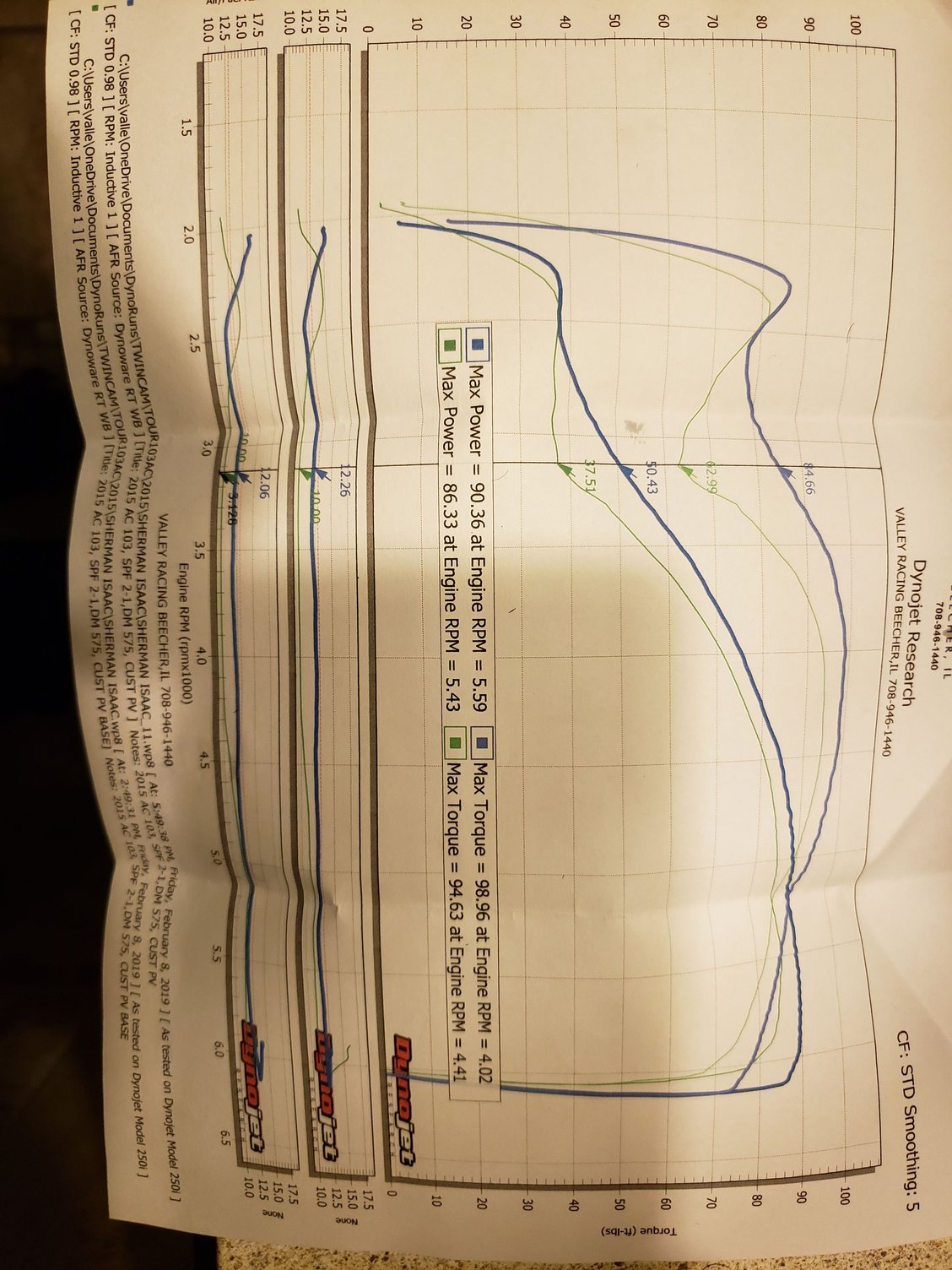

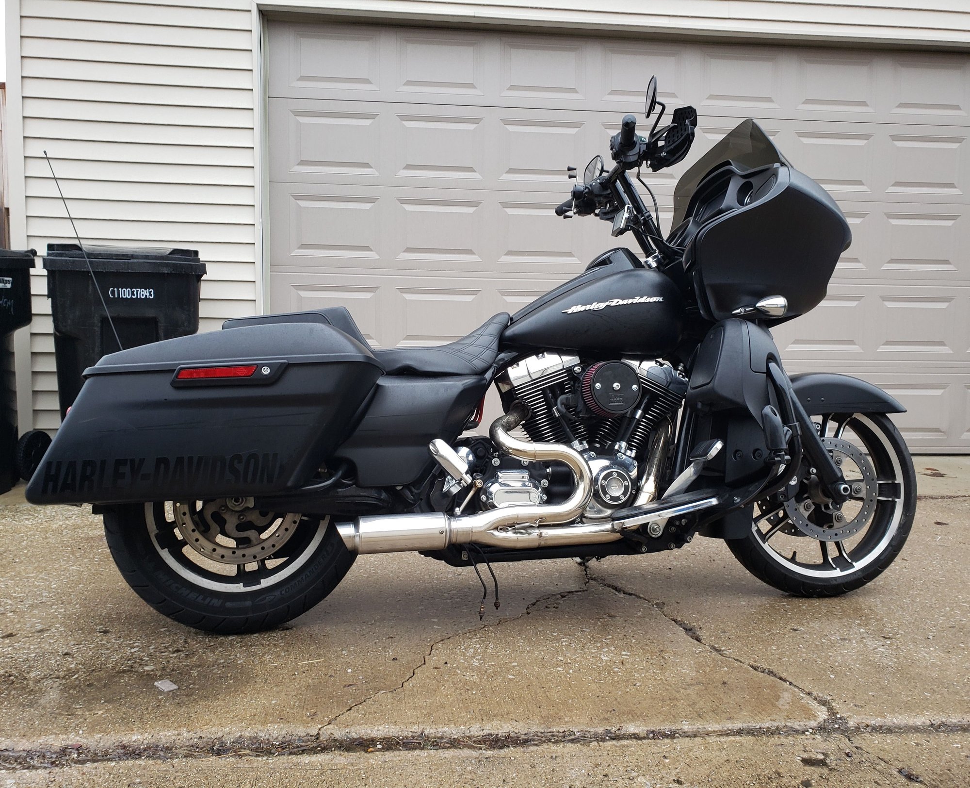

Hey guys, wanted to hear some thoughts. Here's my set up:
2015 RGS
103"
Dave Mackie 575L cams
fuel moto air cleaner
SPF stepped head 2-1 exhaust
Power Vison
Just got my bike back from a very reputable tuner and was a little surprised at the Dyno chart. I replaced my Rinehart Slimlines with a SPF and I figured I'd lose some torque due to it being so short but I didn't think I'd see a dip like this. As far as rideability it does feel "soft" in the 2200-2900 range but feels like a good tune.
Short of "dude, get a new exhuast", any recommendations on getting back some low-midrange.
Also the SPF has stepped headers 1 3/4"-1 7/8"-2" and a 2.5" diameter 8" long perferated baffle core.

Compression would help but I’m sorry to say “dude, you need another exhaust”.

I am assuming a 2.5 collector? I don't like to go down in size after that so, I suggest reworking your baffle with a spiral louvered.

Yeah, collector is 2.5 also. I was thinking of making my own 2" perferated baffle, why are you against reductions after the collector? I'm sure I could find a 2.5" spiral baffle and make it work.

Form over function for this guy. I'm happy with the tune but I can feel a "soft throttle " at the 2500 rpm range. if theres something I can do to flatten it even a little, I think I'd be happy.
I bought a thunder torque insert from DK customs. I've used lollipops in the past with success, gonna give this product a try and dyno it again and see what happens.

Cool pipe issue...???
Not sure that the dip is a pipe issue...look at the AFR at that rpm ...both are going down in the 12-11 range ...would try leaning it out some(and the timing advanced a few) ..or start the pull at 2700 instead of 2000 ...which is closer to highway speeds (and is where the fuel is starting to get right ) ...
really seems like a tuning issue...
